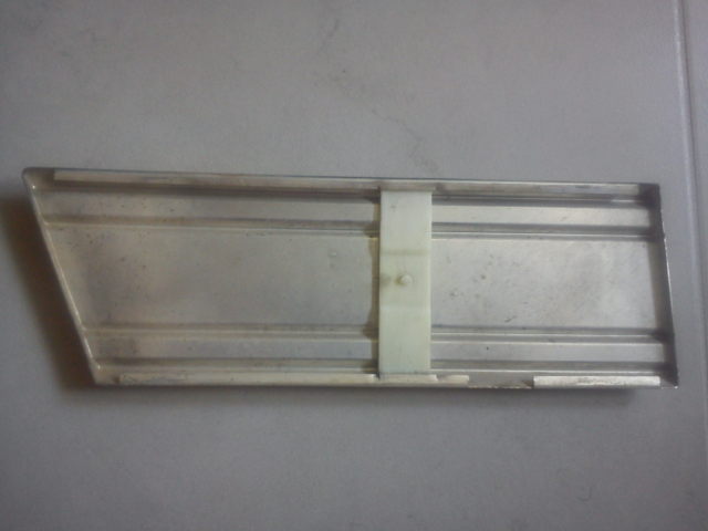

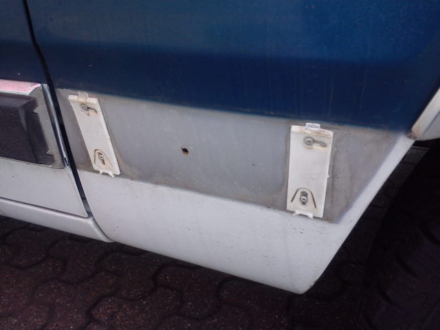

i cant´t explain it on english because my english is not so good (i´m from Germany) but maybe the photos i took will help you. One of my trim at the fender felt off, because the clips are broken downside.
Attached Thumbnails body trim removal-2sayzw2.jpg   body trim removal-op1aq9.jpg

Thank's for the pics, and thanks for the help guys, I'm a big believer in the fact that if one want's a nice paint job he should take off as much of the trim as possible, and especially because I'm gonna change the colours I dont wanna have to mask off the trim.
