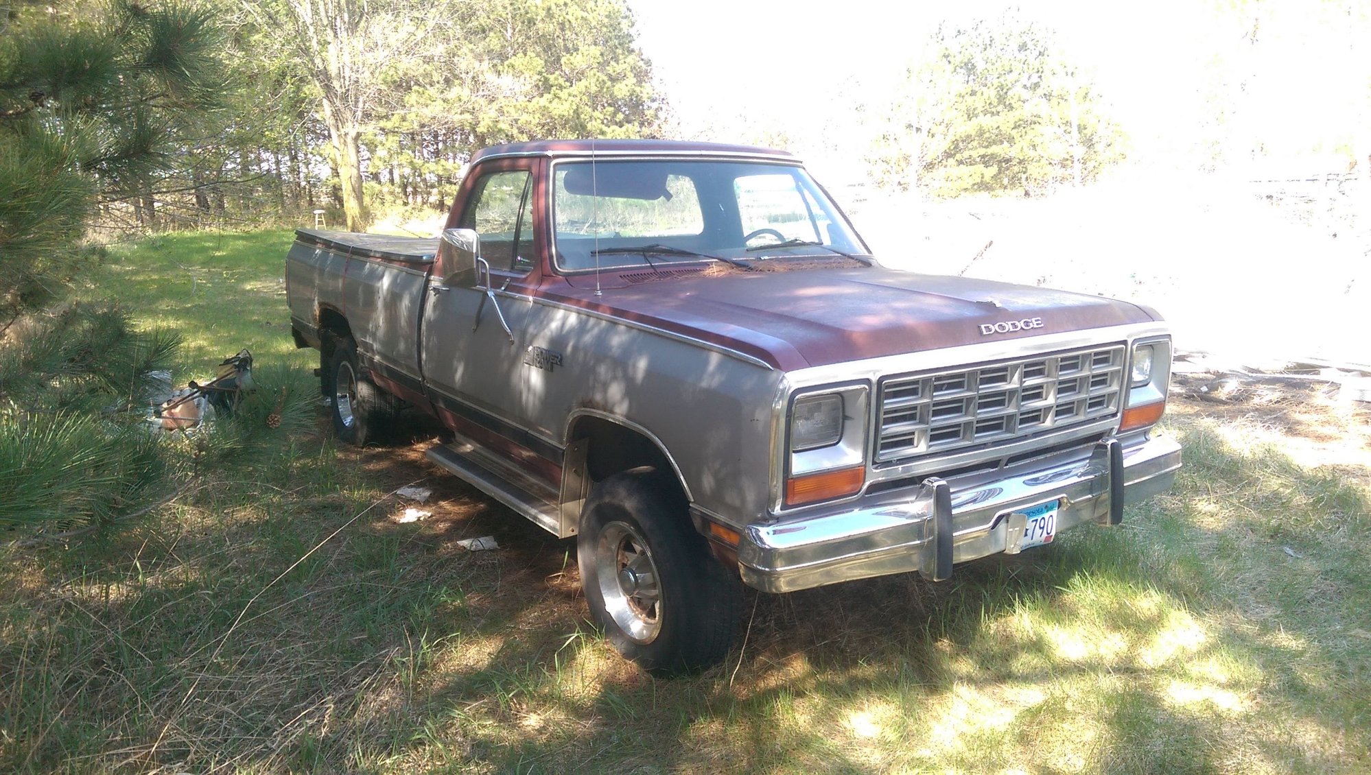

So I bought a 85 power ram with 5.2 2 barrel carb from my boss for $300 It didn't have a battery in it so I hooked jumper cables from my jeep straight to the cables on the truck it turned over but slow figured not enough power through the cables alone. "Cheap cables" so I grabbed a battery my boss had hooked up to a solar panel for a couple weeks put it in the truck hooked up the cables went to connect the jumpers from my jeep and huge sparks I hooked them up properly red to red black to black. Now after that no lights will come on in the truck and nothing when I turn the key can't find any blown fuses what could be wrong? Sorry for the long post

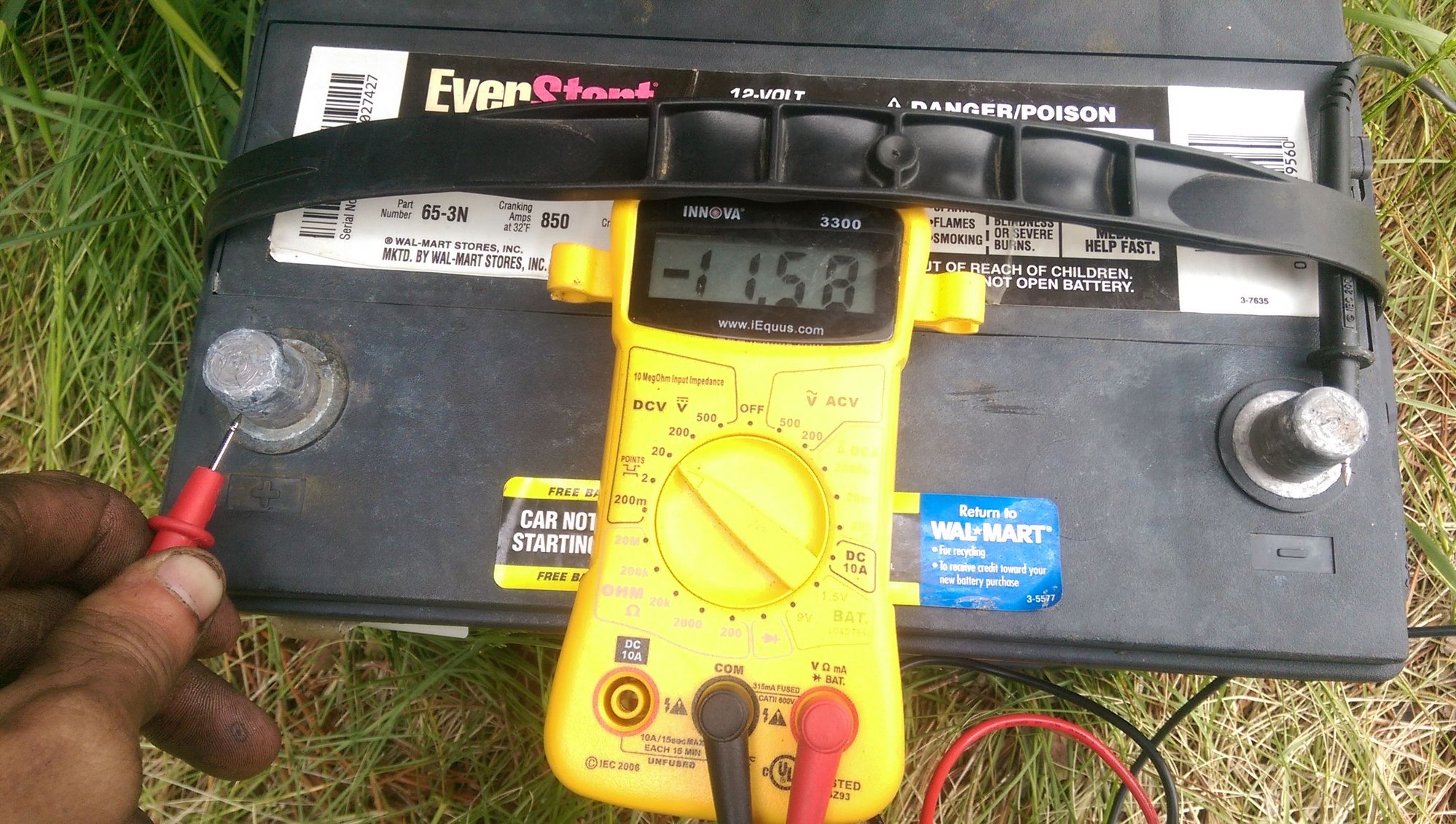

I checked the battery I had put in it and the poles were reversed negative to positive and positive to negative so that's what caused the problem but still not sure what burned out checked fuses all are good
