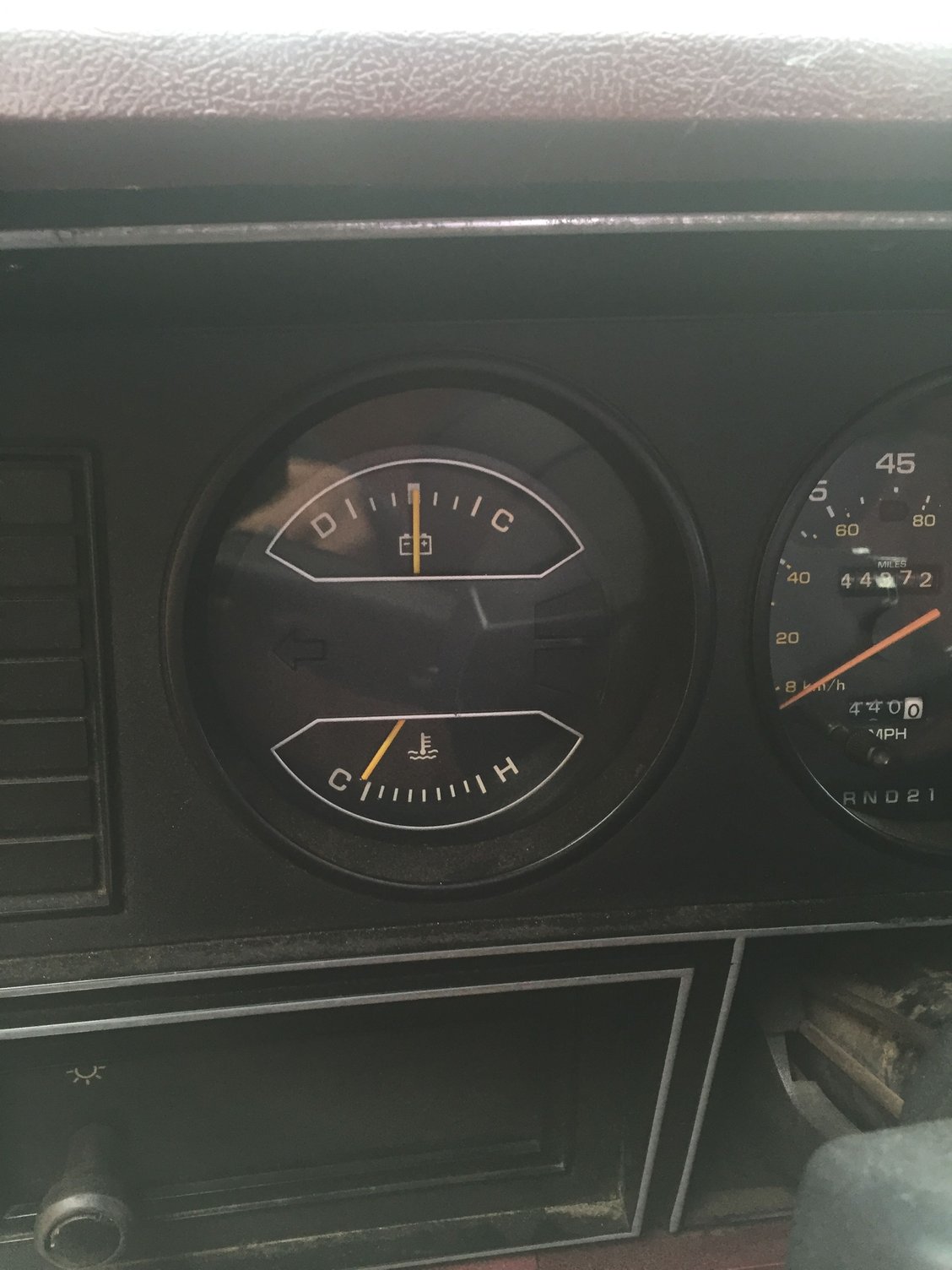

While this works really good for keeping the voltage at 13.9 or better at all times and rapid battery recharge, The amp guage reads discharge at times even though the voltage is close to 14v.
The question is by adding alternator 2 and routing its output direct to battery is it possible that I've reversed current flow "backwards" through the guage, and if so will any damage be caused to the other stock ECM regulated system.

Any more ideas on why the factory amp guage goes to discharge even though my digital voltmeter says 14.4v at the same time?
