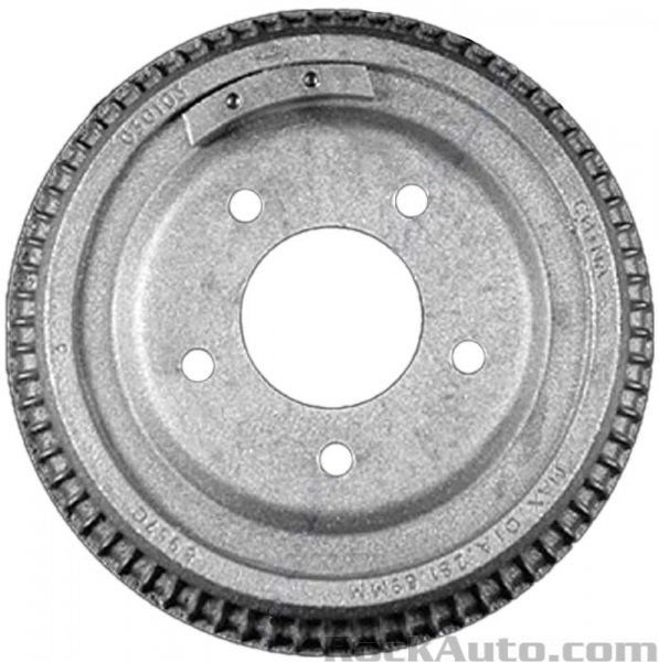

what about rear drums? do they still have their weights if they had them? i don't know if you can have those balanced or not but could maybe cause a shake if far enough out of balance.

didnt even know rear drums had weights, ill see what the manual says.

not all drums are weighted. it is just like rims and tires. some may need weight while others may not but most usually have a pretty big weight welded to them
