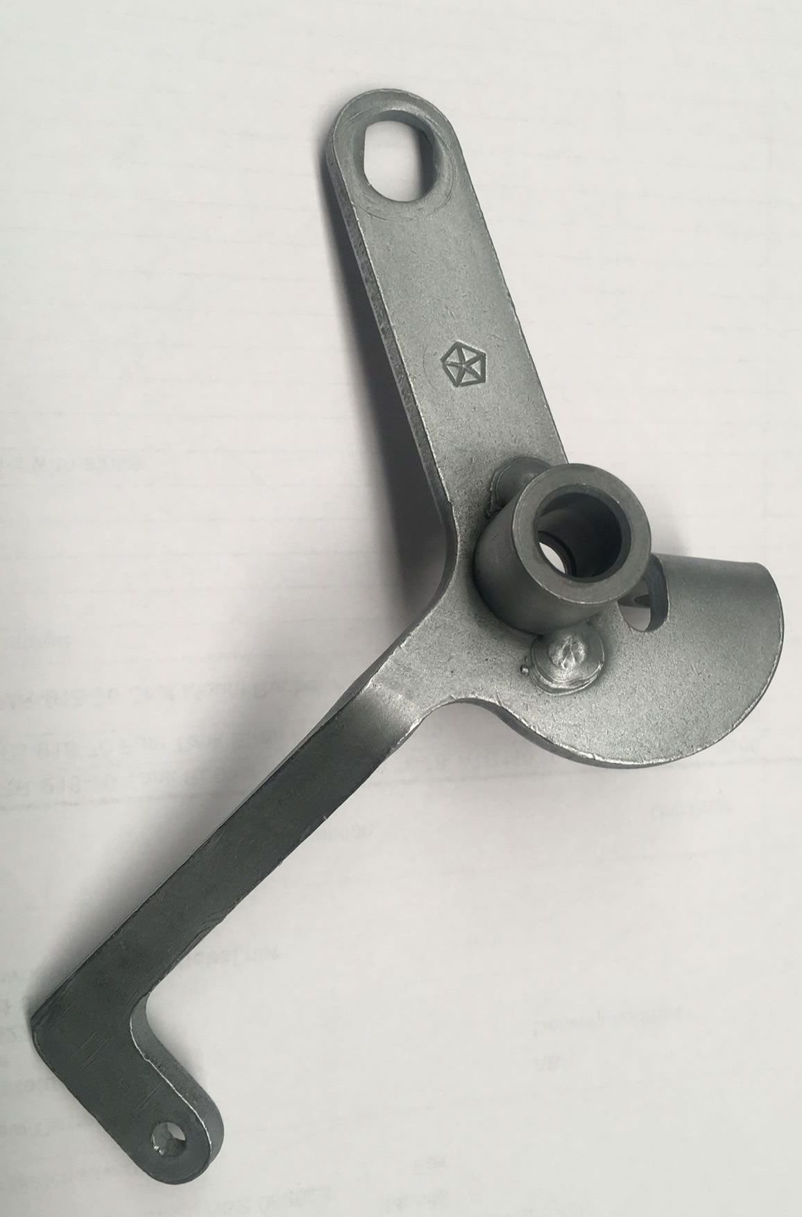

Just did a little more plating this weekend, found the bath wasn't working to well so dumped the solution and made a new brew.
This little item turned out well for a home done job, probably needs on more dip in the bath for the final plating
