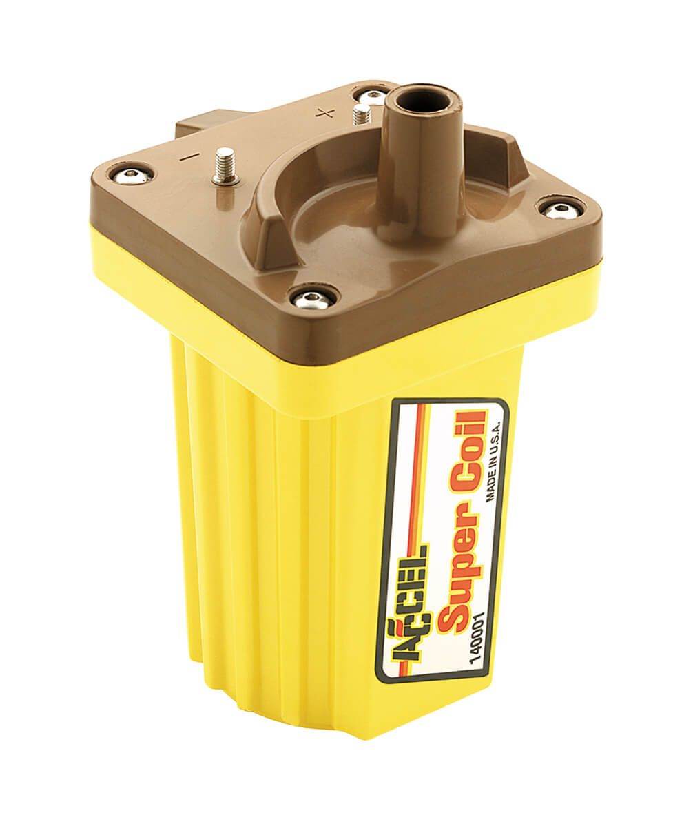

Well mines not stock, cam headers modded spread bore Holley and Edelbrock intake. I hooked up the MSD box with an old school Accel super coil. Got more voltage than any stock coil. If you are going to run the MSD you don't need the ballast resistor. I actually bench tested the combo and if you back the coil wire off from the ground it will actually spark over to the negative on the coil.
