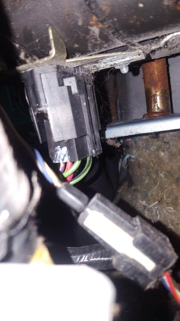

Okay I had the year wrong on her truck.
It's a 1992 and I looked under the dash and there isn't a connector like the one you described. She's already bought a multi-function switch so I replaced it just to see if it helped. Of course it didn't.
Any other ideas?
I'm back to thinking it might be headlight switch itself.

Nope not a tilt wheel. Thanks for the wiring diagram. I'm going to yank it apart next week and get my multi-meter out and start testing stuff. I did test at the headlights and am not getting power to them on low beam and then get power on hi beam but again only when you hold the switch towards you. I'll pull the headlight switch and test it also again. Can't find any burnt wires that I can see so I am scratching my head on this one.
