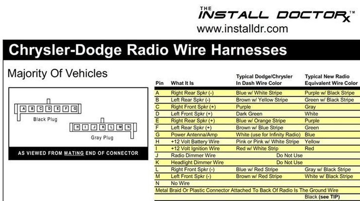

So the guy who had the 88 ram d100 before me decided to take all the original radio wires out and run his own or something and it’s all just a big clutter of wires in my dash and I have no idea how I’m going to re wire an aftermarket radio back in... could someone send a diagram or a picture explaining the wires and the colors so that I can bring it back to original as possible please

the original power wires should be there and that is really all you need. doesn't hurt to run aftermarket wire to the speakers.
