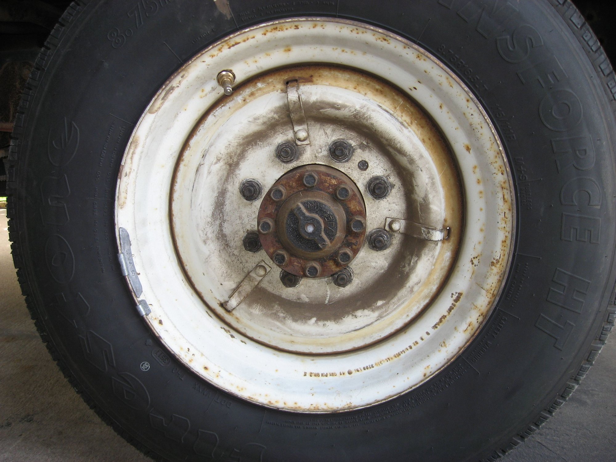

Hello all,
I need some advice. I have a 1982 Dodge D360 1 ton with 16.5, 8 lug wheels and I want to put on 16 inch 8 lug wheels and tires. Has anyone done this? What new wheels will fit over the brakes? Or, will I have to replace additional parts?
Thanks!
Richard

Best fit are 80-93 dodge 16x6 wheels. No brake or lugnut changes.
You can use ford wheels and some newer dodge wheels, but you likely want fatter-seat lugnuts because they're meant for fatter studs.
