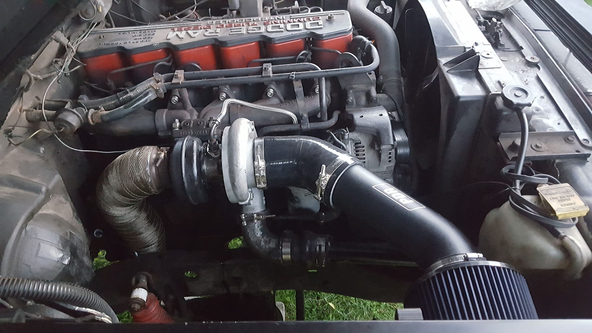

Hello everyone,
I was looking at a twin intake for my 91 Cummins but it only shows that it only fits a 94- 98. Is there any difference in the air manifolds between the years?
There is the link of the parts that I want to get:https://www.xtremediesel.com/banks-power-42710-twin-ram-intake-manifold

from what i reading i have done you would need new injection pump lines to run it. they have also said you won't notice much of a difference untill you are making 500hp+. i would recommend just re-sealing your current plenum/grid heaters and upgrading the turbo if you want to do some stuff that will make the truck more fun to drive.

If it's a 3" intake horn connection your after, dieseltuff has some simple elbows.
