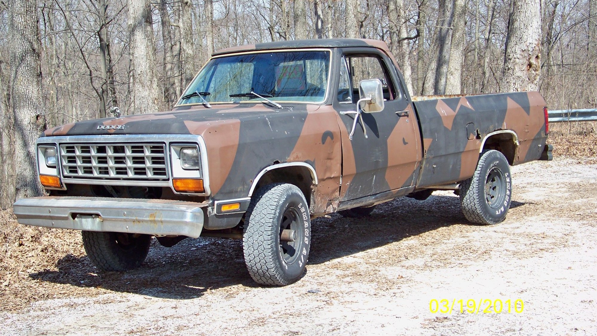

If you can find them, I ran a set of 31X10.50/15 tires on my '84. It filled the wheel wells just right and never rubbed. That old truck went everywhere and even broke trail for the fire department when we had a heavy snow. The tin worms eventually got to it.
I miss the old gal. My current '96 Ram 1500 is okay, but I still miss "Betty". Here's a tip, if you paint it, don't paint it like that. I lost it a couple of times in dark parking lots.
