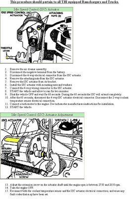

What motor do you have? 92 was the first year for the magnum so if you have a 318 it's the magnum if it's the 360 then you have the LA witch looks like the diagram below.
