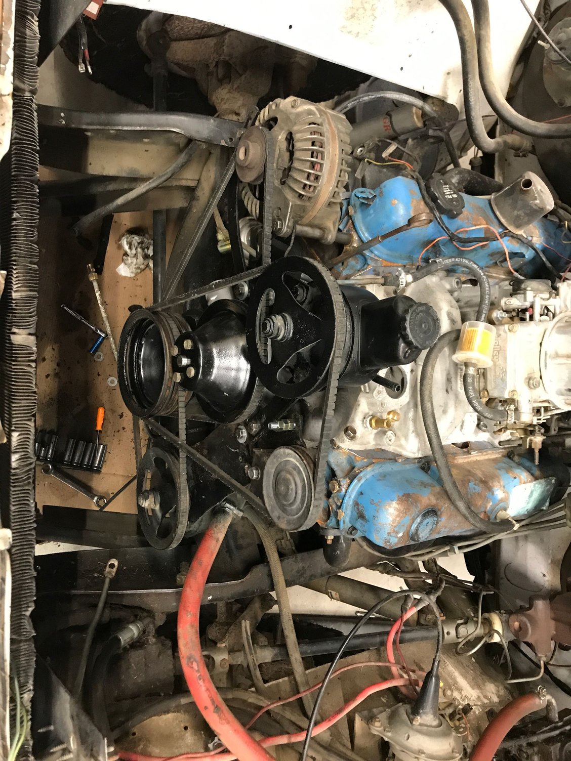

These are some images I found before I started this thread. You can see the idler/tensioner to the right of the power steering pump. That is the part I am trying to get re-installed. Just can’t find the info so far. I will be mounting the pump today. I couldn’t do it yesterday because it had wet paint on it. I figured I would pretty it up a little since it was apart. I will post pics of my setup as it is now after I go to the garage.

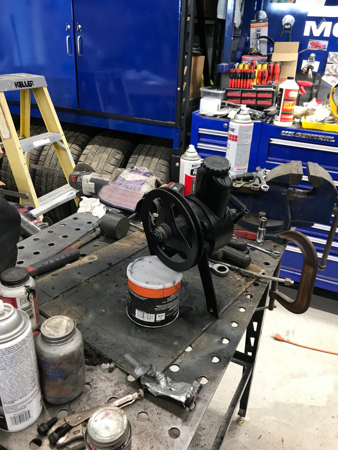

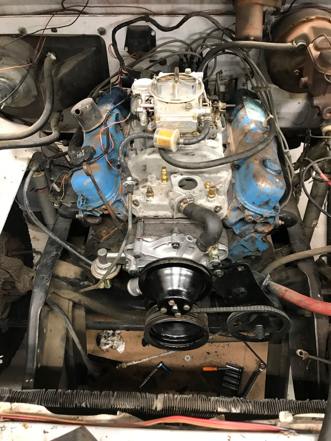

Here is the 360 waiting to be finished up.
Not pretty, but it does work.

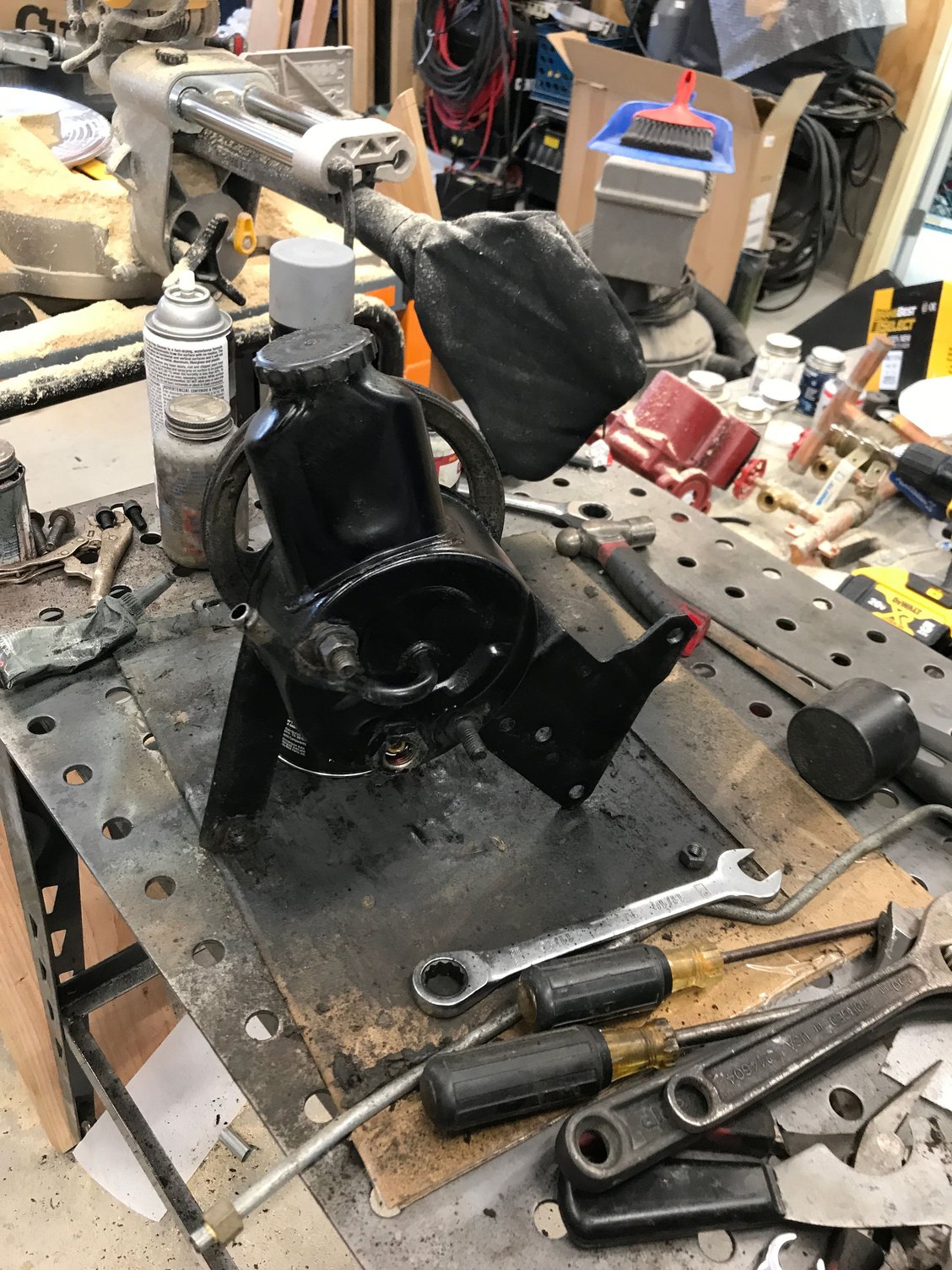

Pump waiting to be installed

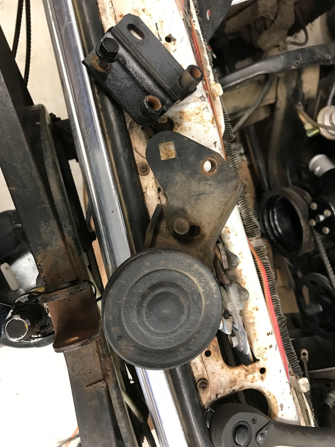

This is the tensioner and bracket.
It may be more obvious once the pump is on the motor. We shall see…

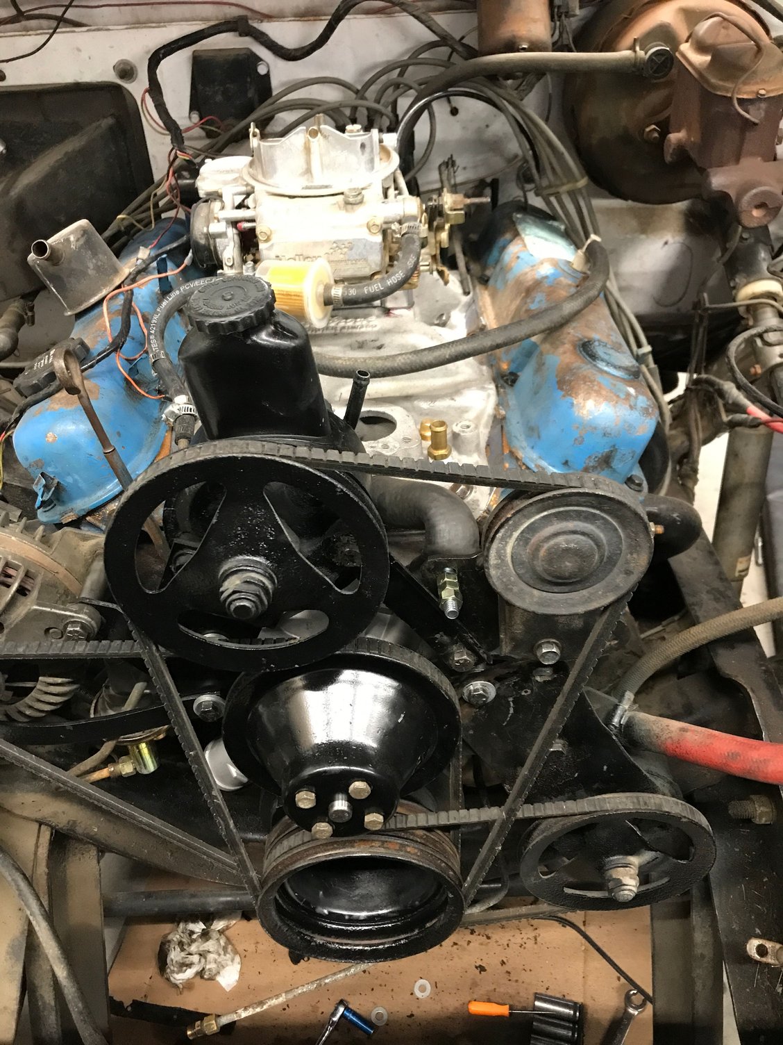

And, as luck would have it, I sort of re-engineered the power steering mount, or at least the tensioner, so it should work. I still have to put the radiator, fan, trans cooler lines, heater hoses, exhaust, and probably more, together. But right now all three belts are on and tensioned up. I think I am good to go now. It is Christmas today so I won’t be working on it again until at least tomorrow.
Finished tensioner config. For now.
Sorry it is sideways.
