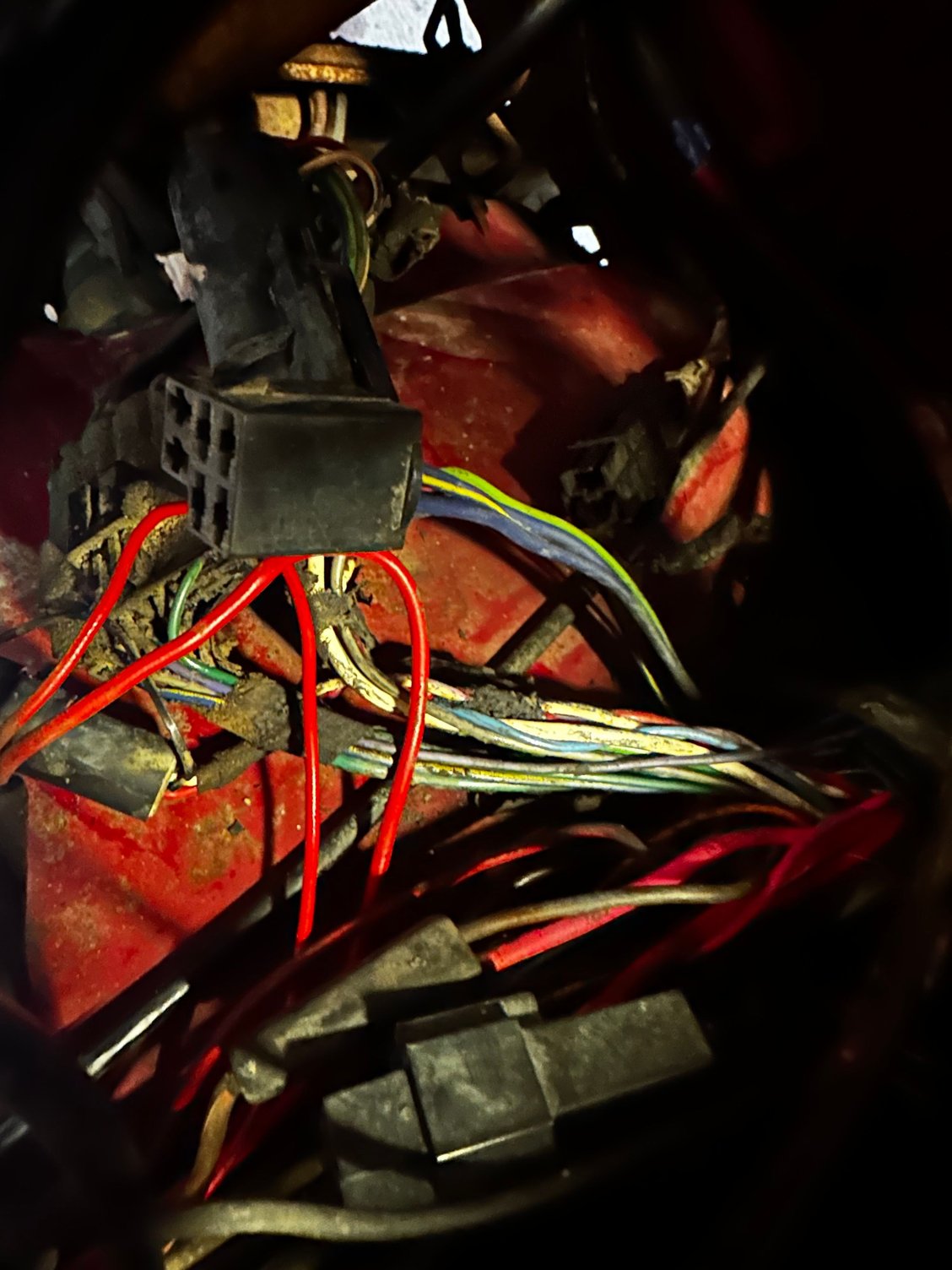

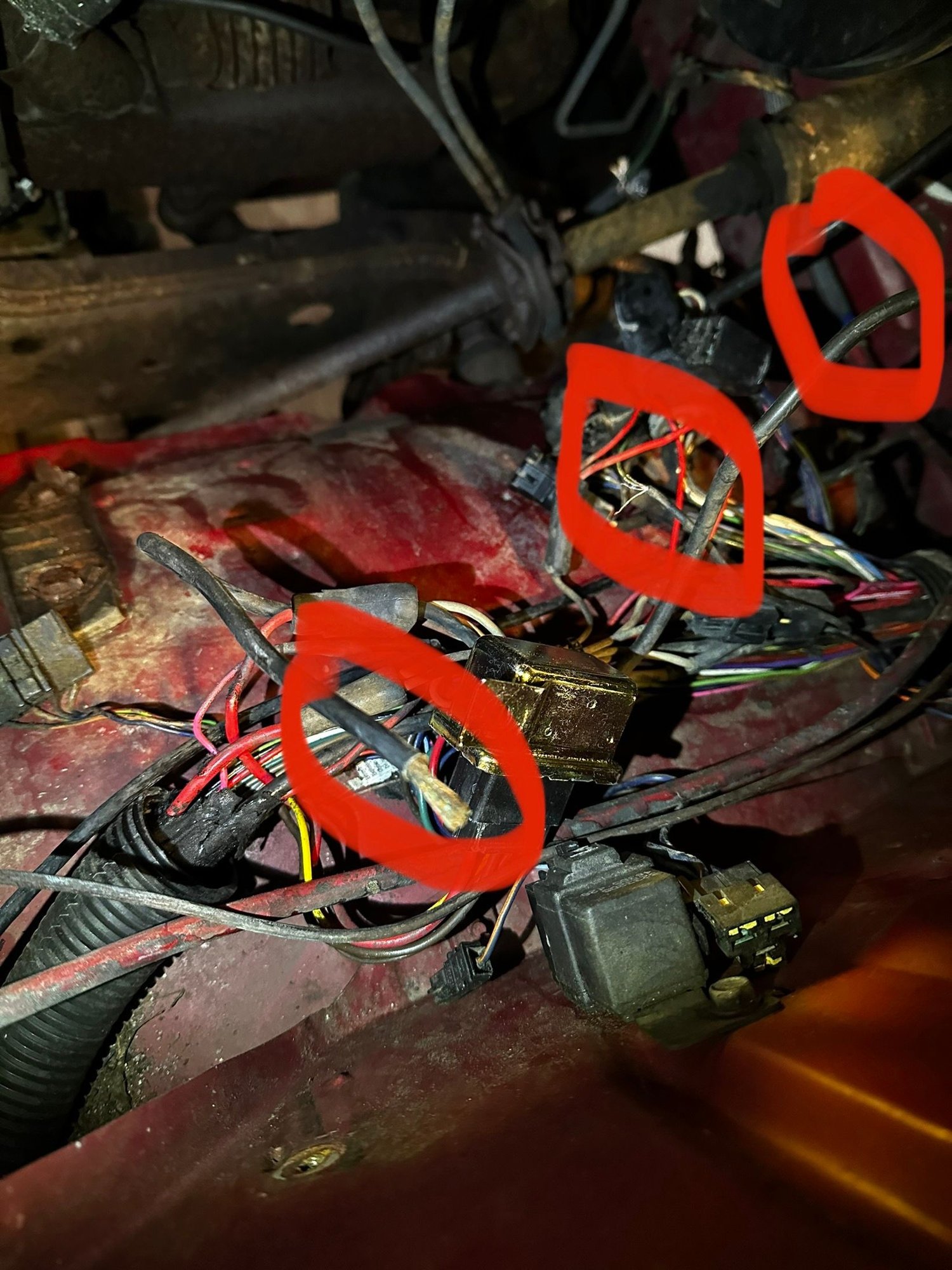

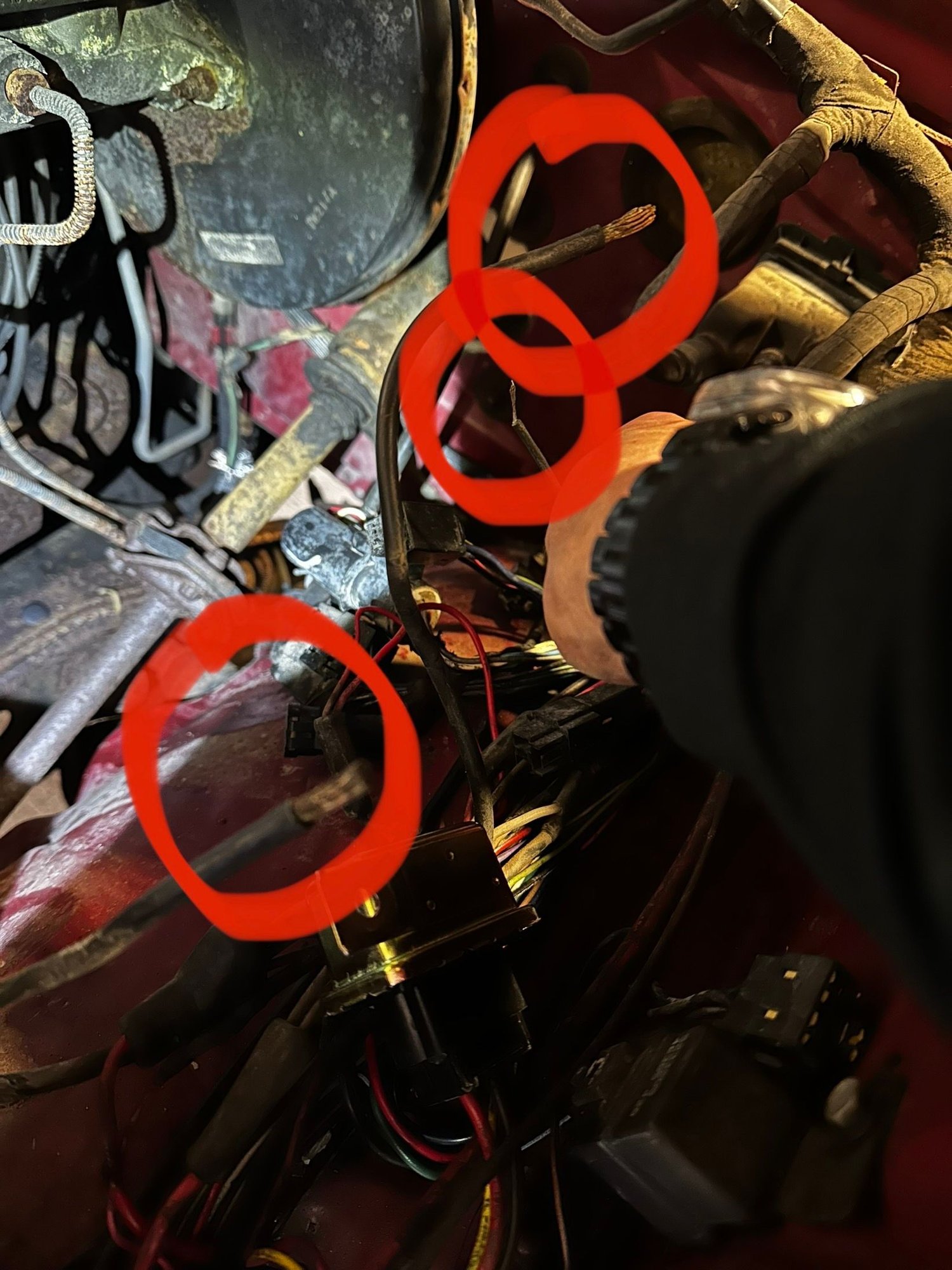

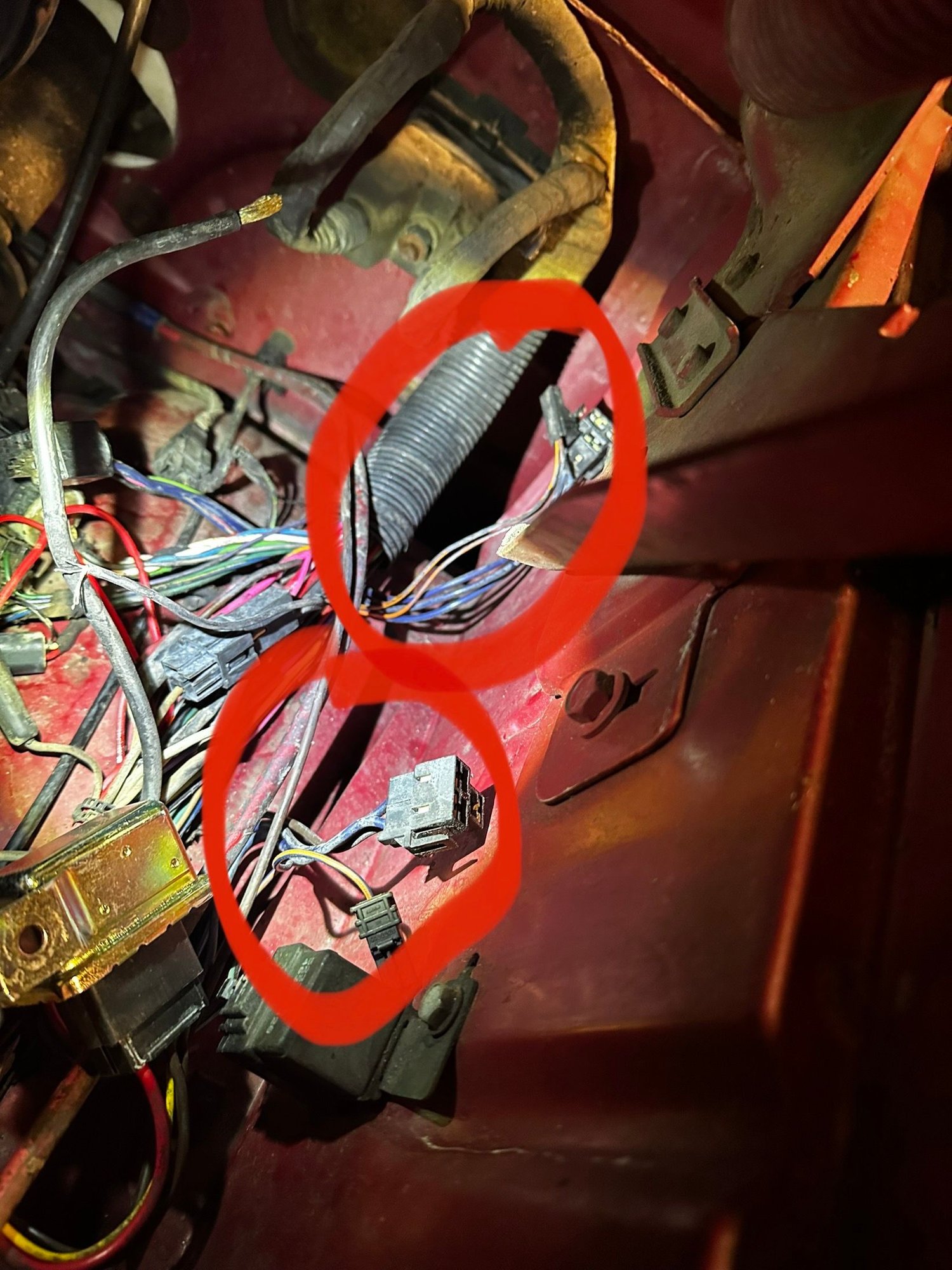

So I recently inherited my old man 1989 W150 5.2L that he had been working and unfortunately he is no longer with us for me to ask wth he had going on. I first changed the distributor cap plugs wire and coil and I had the truck running. however I ended up needing to replace the fuel pump and lines and now I am getting fuel but have no spark. When I originally changed the cap and rotor i realized the shield had rust in but was to lazy to change the whole distributor out then. I recently placed the whole distributor and still no spark along with no power before or after the coil I’ve checked all the fuses/grounds and they are good. After some research I’m noticing it does not a ASD relay (pictures attached) but the truck ran previously so I have no idea. Any help or thoughts would be great.

If you have fuel it has a ASD relay, Positive power go to both the coil and fuel pump if i recall. The relays are on the side of the inner fenders but don't know the location. Best to get a diagram.

you can call it the fuel pump relay also if you want. it powers almost anything under the hood that requires power when running. it will only be on for a brief time till it the computer detects cranking and turns it back on. you can try bypassing it and making a jumper from the positive terminal of the battery to the positive terminal of the coil for testing purposes. this will help try to determine if you possibly have a wiring or computer issue.
