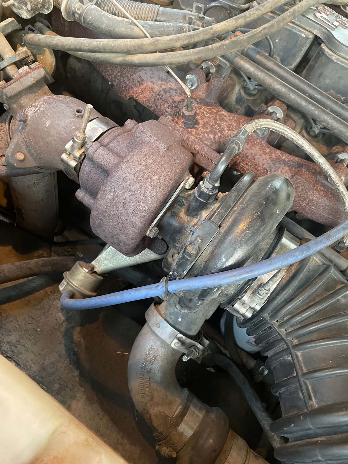

Bought a 93 eclb d250 in April, just started doing a bunch of turbo research intending to upgrade and now I am currently trying to identify what turbo I have on there right now.

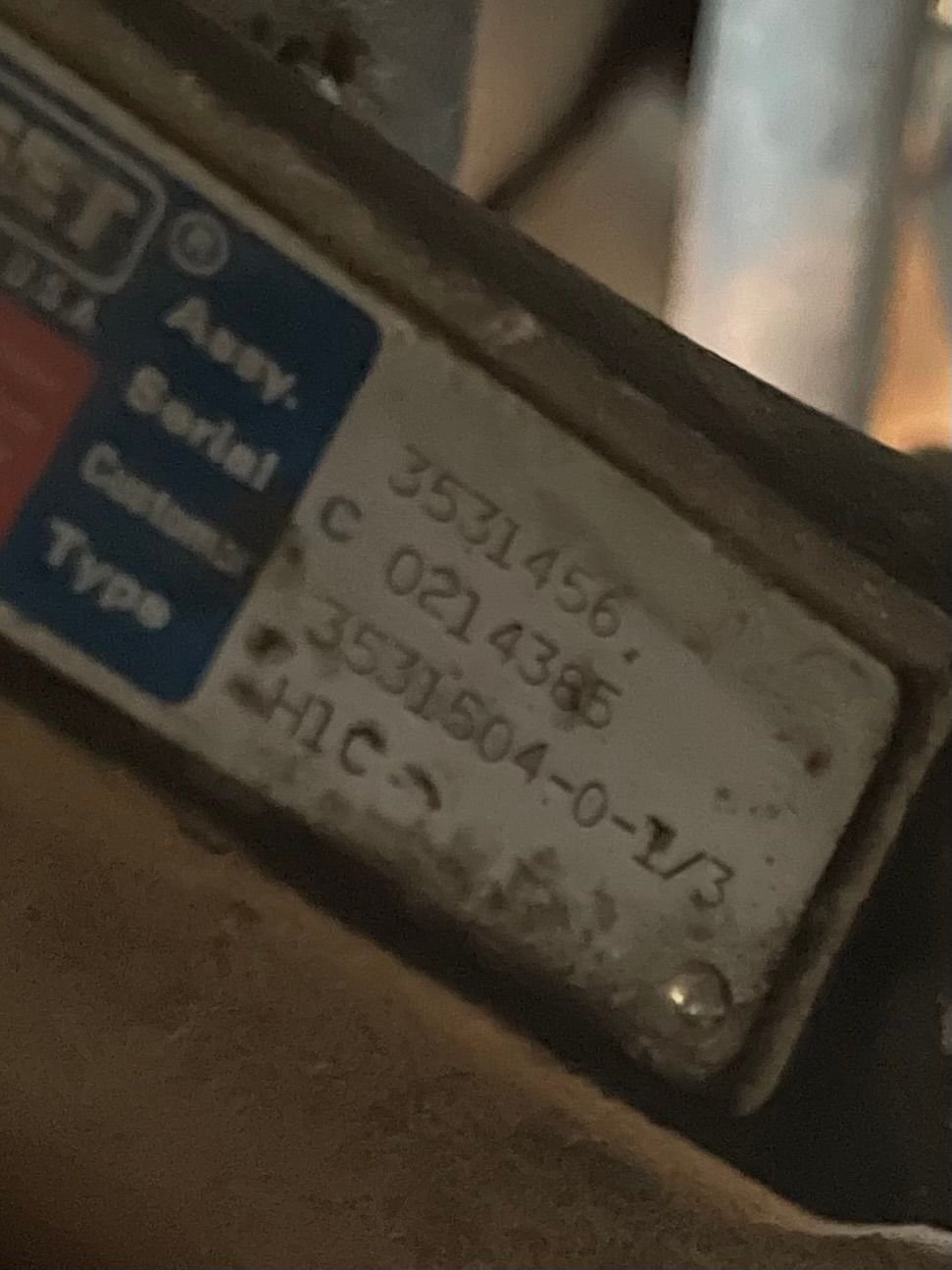

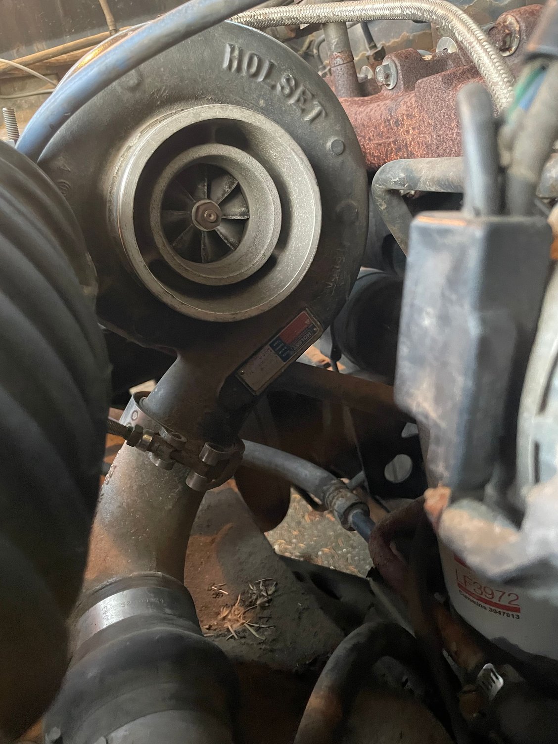

I've looked at the turbo tag and it says H1C, as I expected, but the exhaust housing looks to be a little smaller than an 18cm and has a wastegate. I believe the compressor side is stock, and the exhaust side is off a WH1C, but if anyone else knows for sure it would be greatly appreciated.

Looks like somebody swapped the exhaust side with a WH1C/HX35..... which is all the WH1C is in the first place.
