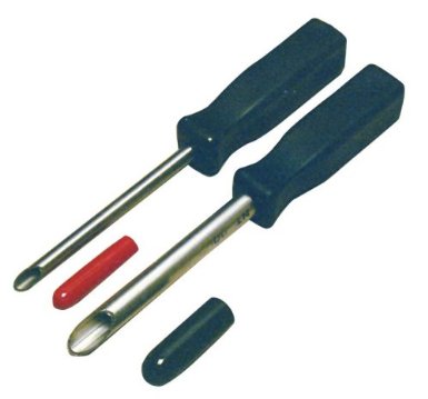

Why don't you just try to tab behind the Cig Lighter socket instead?
I have this tool, works great. Find the wire loom that goes from inside to outside, stab this tool all the way thru, and insert the wire into the hollow hole.
Thexton 476 Wire Insertion Tool Combo Set : Amazon.com : Automotive Thexton 476 Wire Insertion Tool Combo Set : Amazon.com : Automotive
Attached Thumbnails Impossible Firewall Pass-thru?-41opw1fj0ll._sx385_.jpg   Impossible Firewall Pass-thru?-41opw1fj0ll._sx385_.jpg
