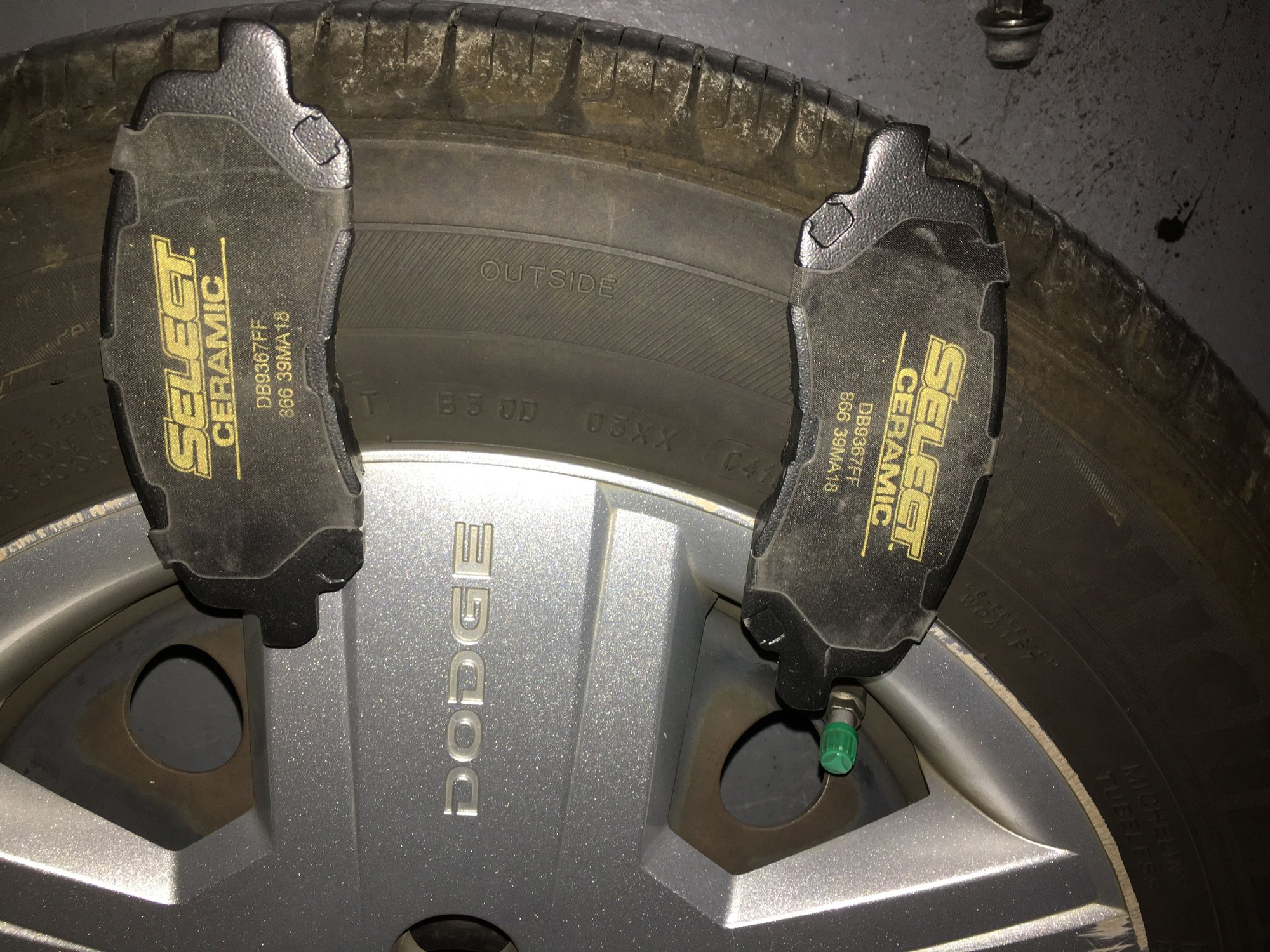

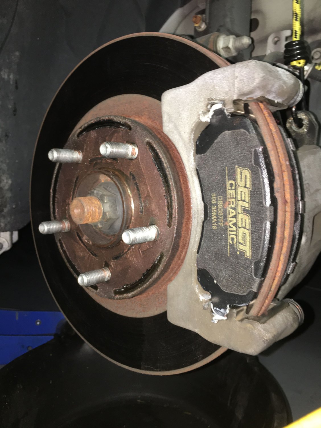

It's been 5 years since I done them so, I opted to replace them with the best pads. After jacking up the vehicle and taking off the tires and calipers I found the Front Brake Pads to be less than 1/4 (Quarter) of an inch left and they seemed to look okay.
Nope, I replaced them anyway as I had the new Ceramic Pads on hand!
It is really strange grinding noise coming from Brake Pads that still had lots of life is my thoughts and they did NOT seemed to be crystallized in any way.
Lately, I have had great results with the Newer Ceramic material for Brake Pads so, I am hopeful these will last a long time. Test drive indicated smooth and powerful stopping power.

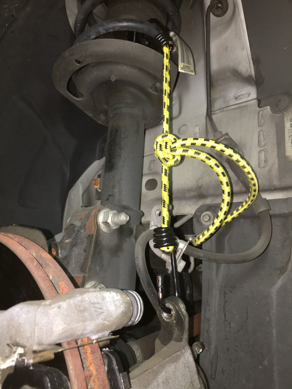

Setup and Jack Stand UP FRONT!

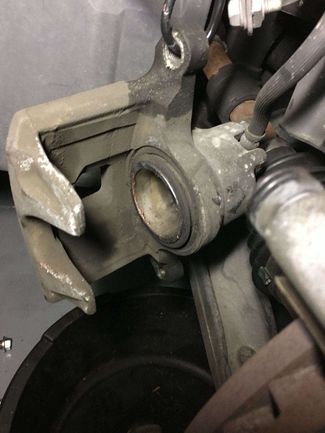

Carefully returning Caliper Piston back.
