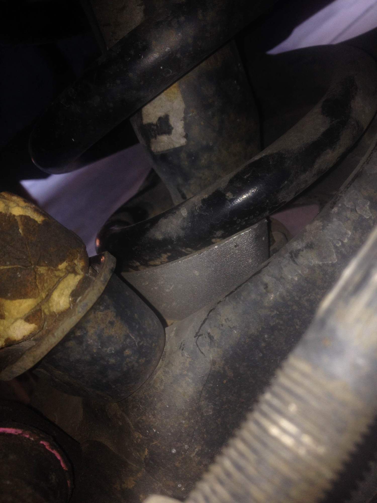

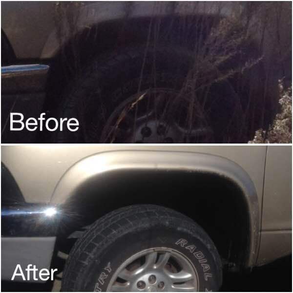

For the front, i didnt want to mess with the torsion bars or any of that, so i ordered coil spacers from ebay from Rad Rydz for $43.99. I suggest getting the upper spacer for this, not sure if the installment process is different but the bottom ones were a pain. I actually had a guy do mine because the steps are painstaking. You'll need to lift the front end of your truck, take off the front tires, sway bars, control arms, and basically everything in that area and also need to remove the coil. After all that putting the the new coil spacer in place and the coil back in along with the 20 other things disconnected, moral of this story just have a professional do the front, its faster and they will need to align your tires afterwards. When the guy set my truck back down he said the coils bowed so he lifted again, rotated the coils, set it back down and it fixed the problem. NOTE: The coil spacers i ordred said 3 inches of lift, and i only got 2.5 inches. It's not a big deal for me but i thought that was kind of stupid. So, if you order this type of coil spacer that says 3 inches, your probably only going to get 2.5. Here is a pic of the bottom spacer in place and the difference from the 2.5 inches of lift.
