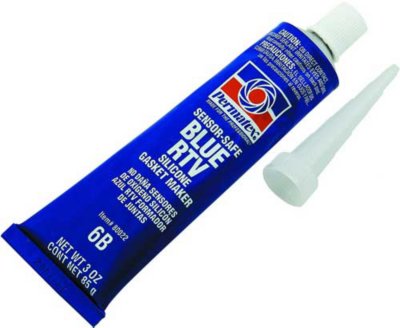

If this still pops open on you redo it with only gasket sealer no gasket the good sealer is like a glue the gasket may become the weak link metal to metal with the Blue or Black RTV Sealant may work better and maybe rough up the surfaces just a little bit not too much so it grips the surfaces better. and clean all grease off
I used the red RTV on my Diff cover and removing it took some prying it was glued on good and tight
