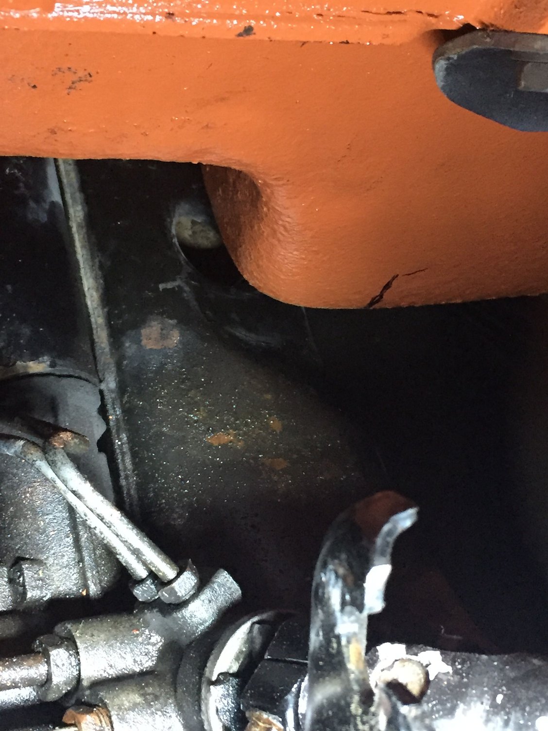

1. Oil pan on 318 is coming close to the cross member and hits it if I bring the engine down to near where i think it should be. The engine is from a 1990 Ram. It is a rear sump pan. But I noticed that the Magnum engines have a thinner rear sump in the gen 2 Dak to clear that cross member. I know the LA 318 was in the first gen Dak before they converted to Magnum in 92. Can't seem to find an oil pan for a 5.2 1991 Dakota though. If there is such a thing where can I get it and would it fit? Or I can cut and notch the current oil pan. Or I can mount the engine higher but the hood may not close and the U joint angle may be off. Ornotch the crossmemebr??

318 sitting high with oil pan touching cross member. Engine is back all the way
Oil pan with mark where I may need to notch
Passenger sideLA meets near Dak motor mount

1) HiPoTek makes engine mounts to go from the Magnum frame-pin to the LA ears for this exact swap. I bet he has a bunch of other tips you could use too. http://stores.hi-potek.com/high-perf...rwd-1997-2003/
2) There's nothing special about the fuel system. The LA motor should have a mechanical fuel pump that you can run for carb. You can try to get the EFI 45 psi down to 6-8 psi with a return regulator if you insist to run the stock tank. I'll probably work ok but make you your regulator has a large return port, you'll be bypassing A TON of fuel.
3) I'm not sure what the best option is with the oil pan. HiPoTek might have an answer for you since he makes stuff for the LA/magnum retrofit.
