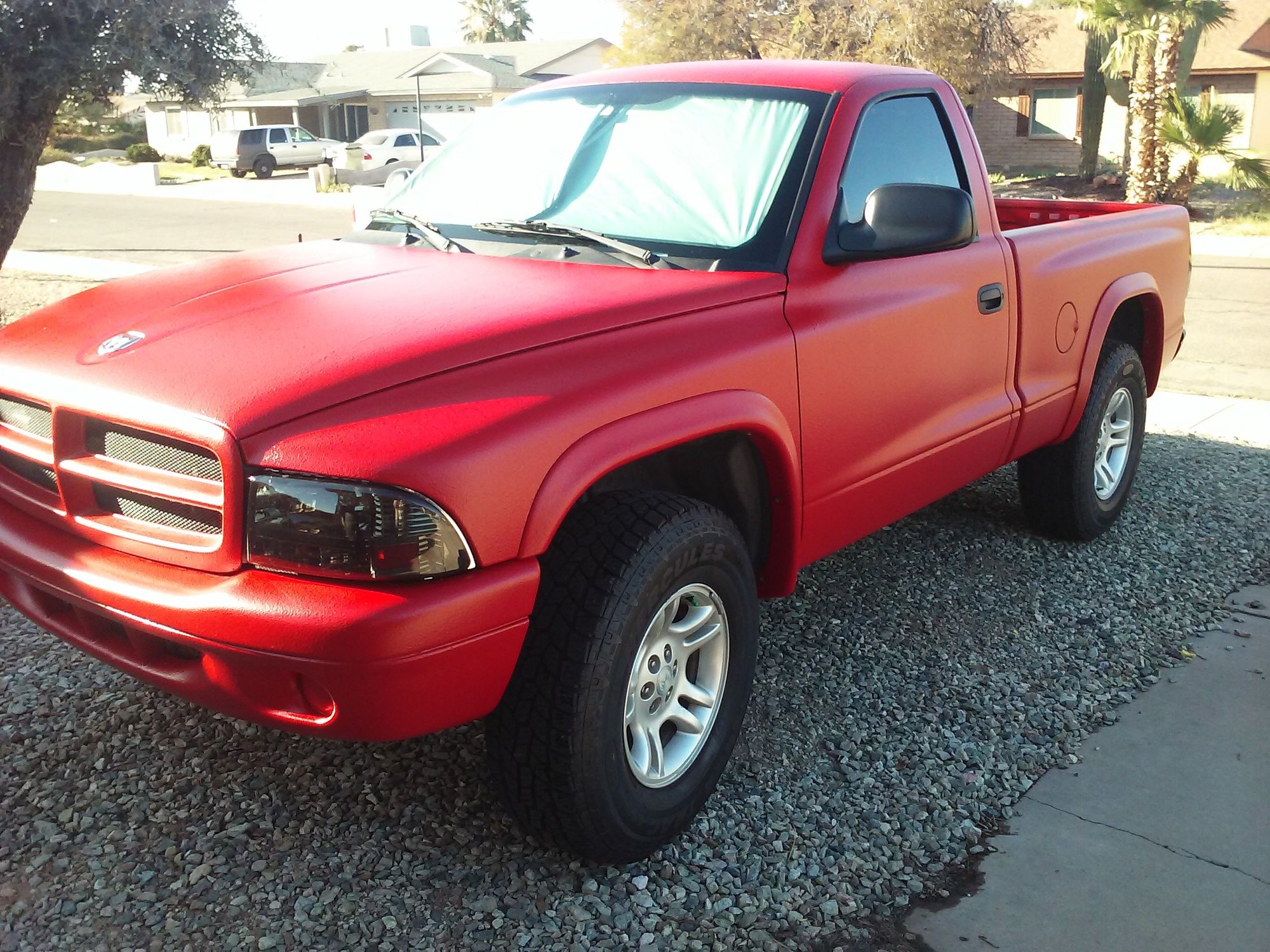

I have been on these tires for about a year now. I did notice a MPG drop from 21 Freeway to 18. It is lifted 2" with coil spacers up front and extended shackles in the back. (it's a 2wd) It's also a dog now with 3.55 gears. I am looking for a decent 3.92 rear axle to swap in.
I haven't had any maintenance issues because of the larger tires, but I had replaced most of the suspension wear parts like ball joints and rod ends before putting the tires on. (bushings were dry rotted and Ball joints were worn out)
Side note: if you go Higher than a 2" lift with the stock control arms, it is impossible to align.. You can go 3" with the Doetch Tech lift, they include custom upper control arms.
