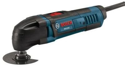

They are a glue-in. Also they have 4 metal tabs that bend down over the pinch-weld to hold it in place while the glue dries. I found one at a u-pull place and installed it on my own, but I was an auto glass installer for too many years.
I would suggest going to a u-pull it yard and take a close look at one. If you can get it out without bending it or breaking the glass and slicing up the encapsulation, you should be able to find a glass shop that would install it for labor + materials.
If you do that, cut from the inside. If you take a blade to the outside, you will only end up cutting the encapsulation and not the glue. Some of the factory installs had such poor paint and primer that you can sometimes just push on the window frame from the inside and the glue will just separate off the glass. I got about 2/3rds of mine loose that way. Then I had to cut the rest of the glue.
If you can get electricity out to the donor truck, you can use one of these to cut the glue:
