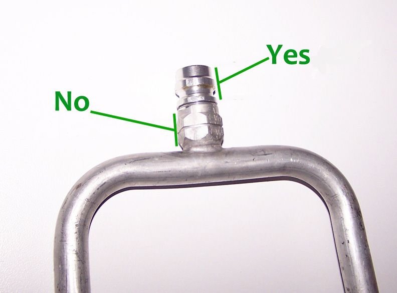

Looks like this the yes is were you remove it the no is dont try to remove its part of the tube its a schrader in a mount is all the yes part the high side port.

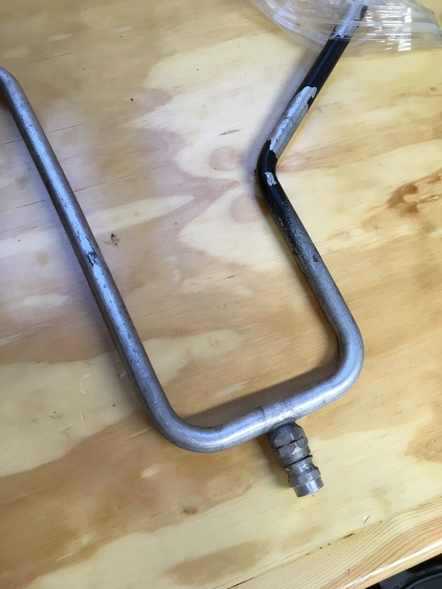

Here’s the line I removed from my truck. As far as I can tell, it’s factory original.

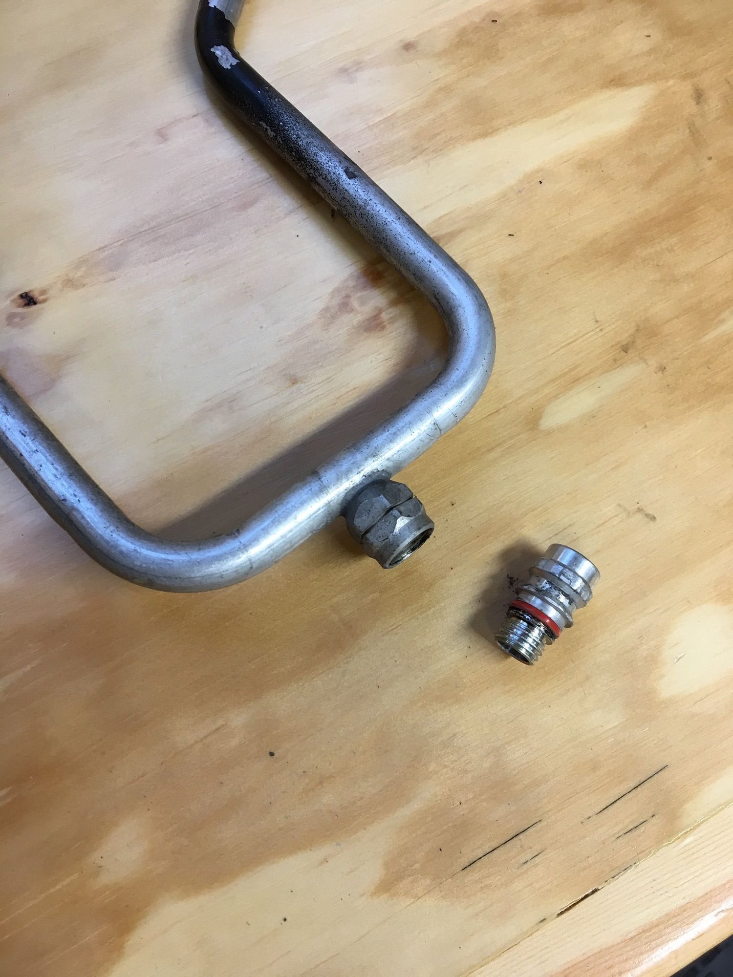

The high side port comes apart, like this.
Note the lack of a pressure transducer port.

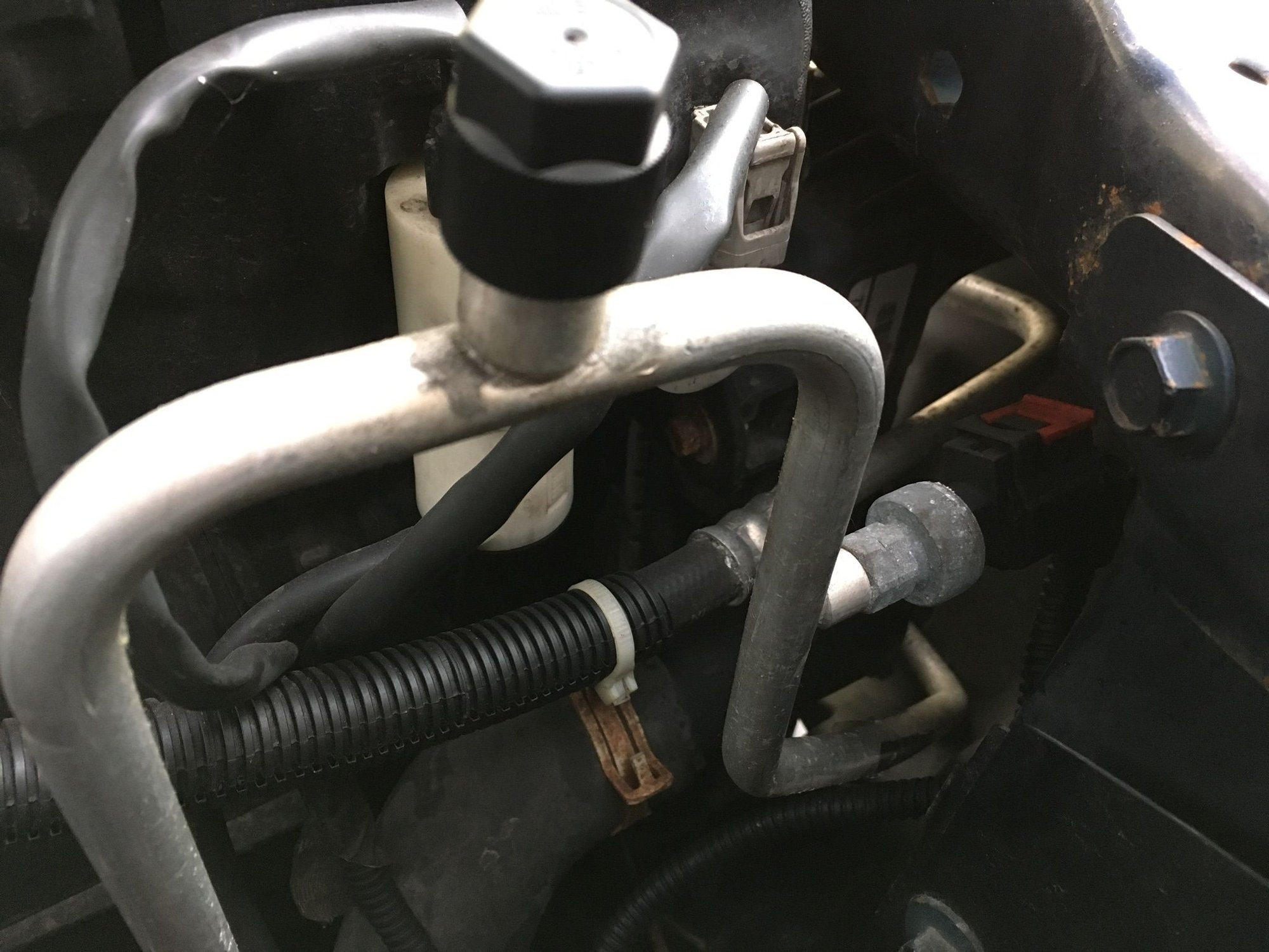

Here is the “new” line, currently in my truck, with transducer plugged in to the wiring harness.
And here is the line liberated from the local junkyard on Saturday.
No transducwr port on this one either.

Thanks. I was hoping to find out if the 01 requires the transducer. I can now report that it does. I put the junkyard tube in, and without the transducer connected, the compressor clutch will not engage. I plugged the transducer in, and the compressor fired right up.
