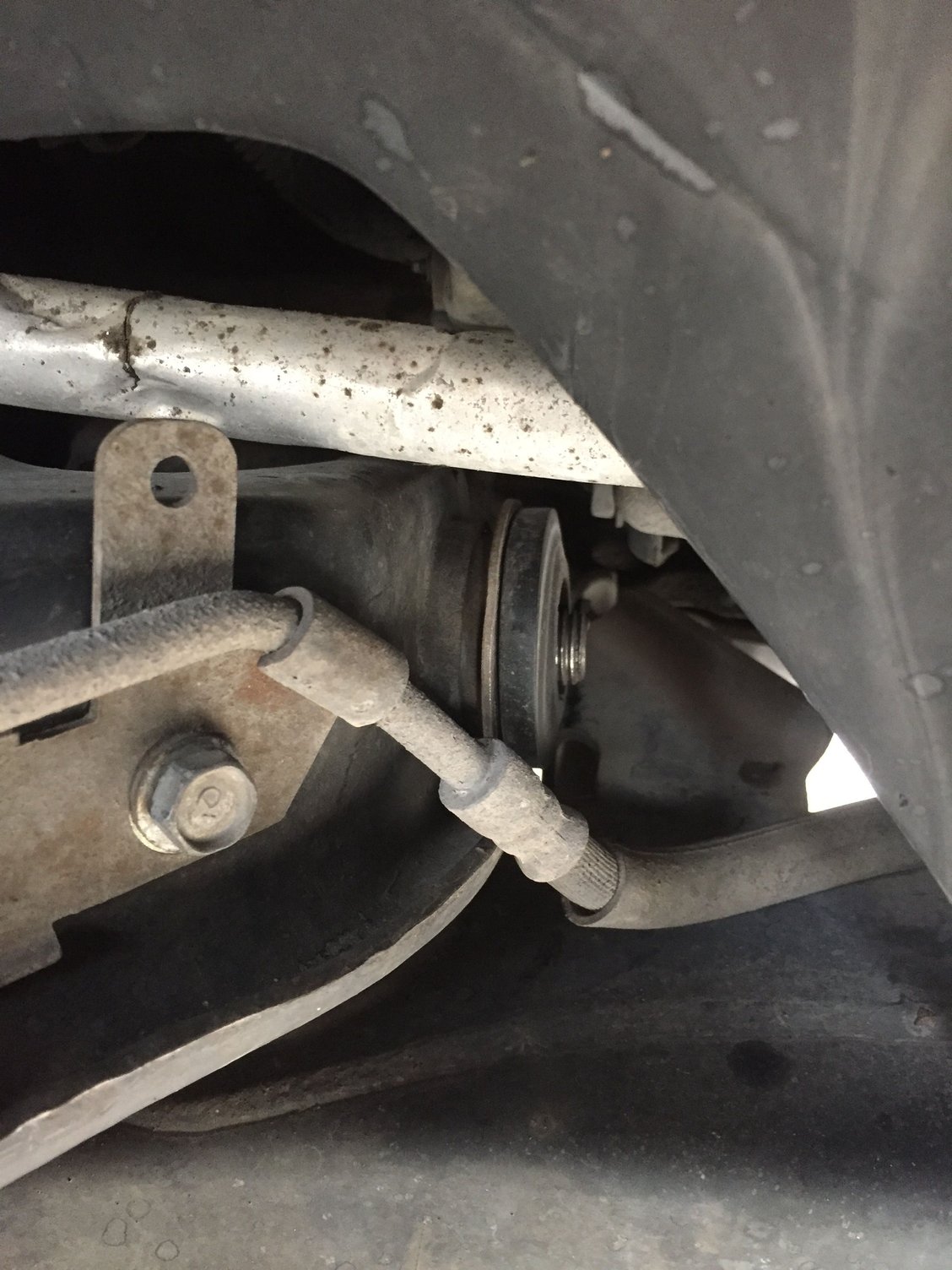

So something bad happened, I lost the nut on the end of the upper control arm. I’ve included a picture if it helps.
Ive been to Lowe’s, oriellys, autozone you name it I’ve been there. I haven’t tried fastenal but the closest is about 80 miles away and this is my only vehicle so that’s out of he question.
So I was wondering if anyone knew of an online source for parts like this? Anything would be GREATLY appreciated.

This is what I found NUT, Hex Lock, M 14 x 2.00
Am I sure no but it sounds about the correct size
Try a lug nut some are that size as a temp fix.
