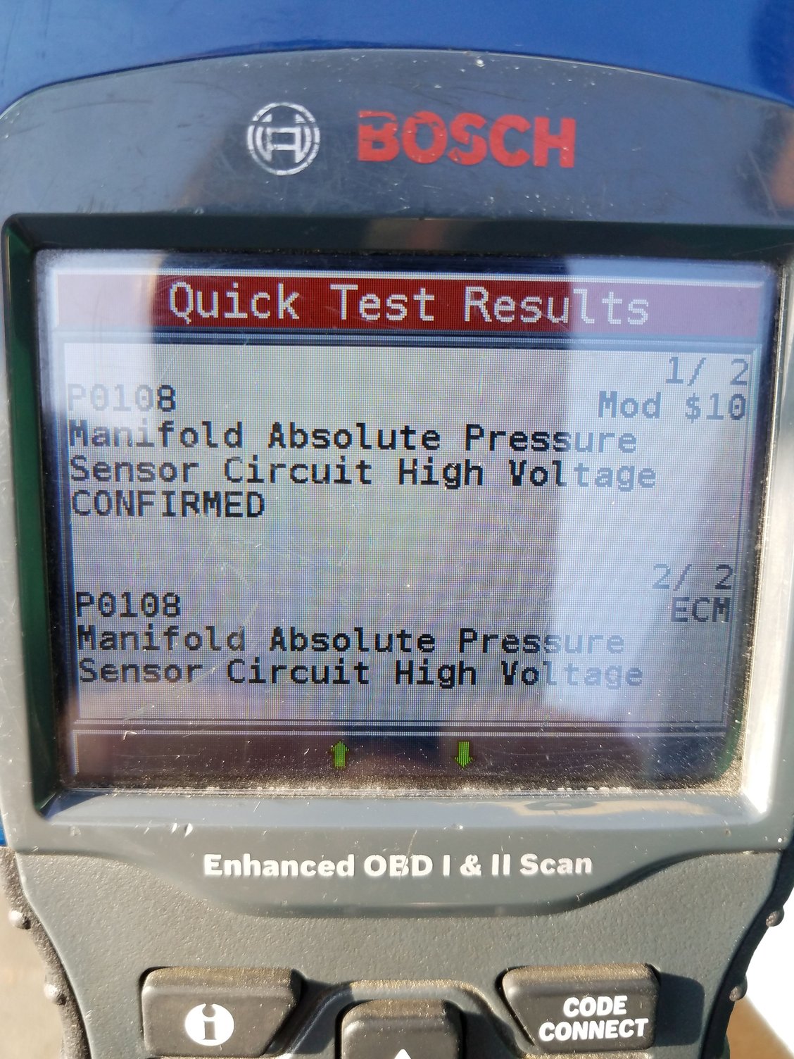

no check engine light, but still stored a code
P0108 . This could be the whole issue right here.

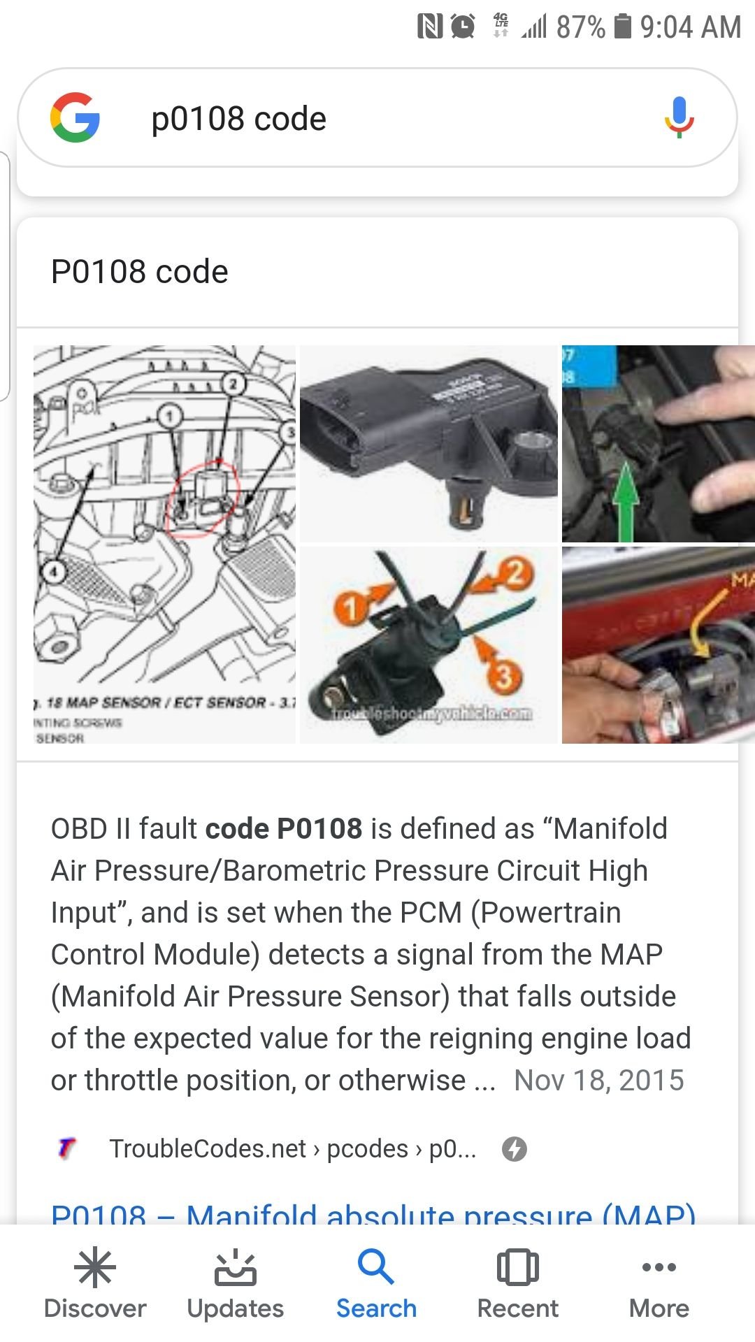

If its the MAP sensor I'm going to be upset with myself and relieved at the same time. I'll know in about an hour & half when I replace it.
Old Oct 10, 2019 | 07:53 PM
E-Von's Avatar
E-Von
Joined: Oct 2019
Posts: 7
From: CA
Replaced MAP sensor. Hasn't died on me. I think the problem is solved. There were other reviews that did mention could be MAP sensor. Something so simple can cause so many problems. Thanks for all your help Man.
