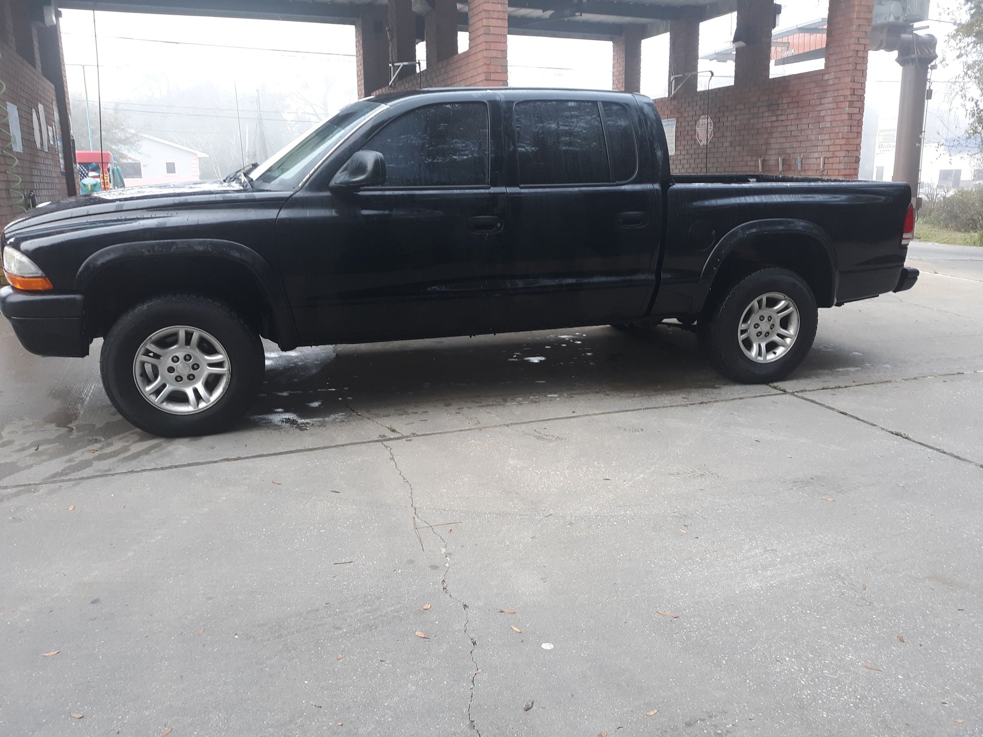

Currently me and my son are building him a 2003 dakota crew cab 2wd 4.7 we did the spring spacers 3 inch on the front and 2 inch lift shackles in the rear but we have run into a couple snags one being lifted shocks where did you get these as I cant seem to find any.. and I've noticed the camber leaning towards the inside of the truck at the top.. was this fixed by a simple alignment and or how did you correct this issue..

You'll have to measure out the shocks and find something close more than likely. Pro-Comp has a huge catalog of cheap shocks.
If it's really bad, you can knock the adjuster bolts loose and just pull the top of the tire out to full limit. At 3", there's fair chance that there may not be enough adjustment and there could be some permanent camber.
