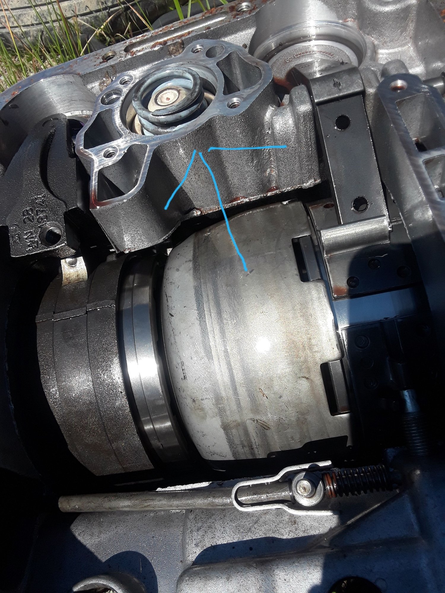

I'd install a kit in it.
It has sensors,governor,
an that spring that breaks a lot in these trannys.pic may differ but similar.
My spring was in 3 pieces an effected the pressure for shifting..I adjusted the bands too.
Yours may be just the sensor but check that spring!

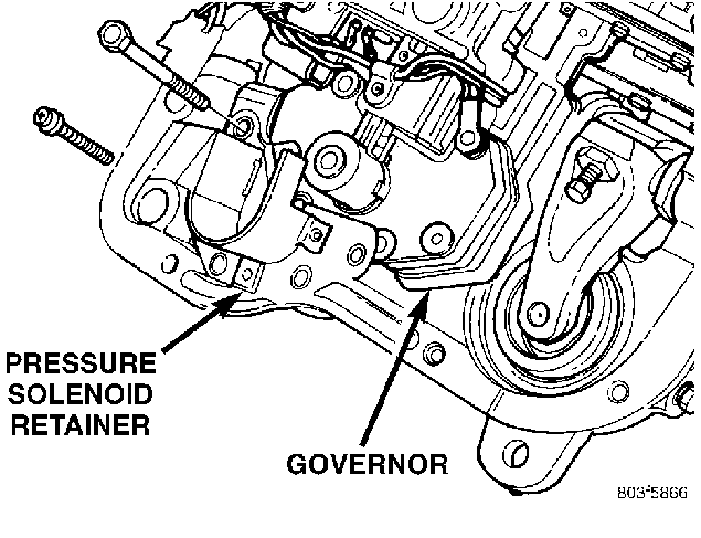

Heres where my 2 sensors are at..
