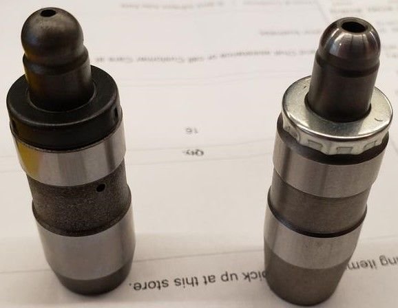

After seeing the price of Mopars, I used Sealed Power lifters (Federal Mogul). They redesigned from the ones that look just like OEM and supposedly the new design (black cap) are less prone to bleeding down. You can see old and new below, as well as the box with part number. All the ones I got were made in the USA but I think they're making them in China now.
