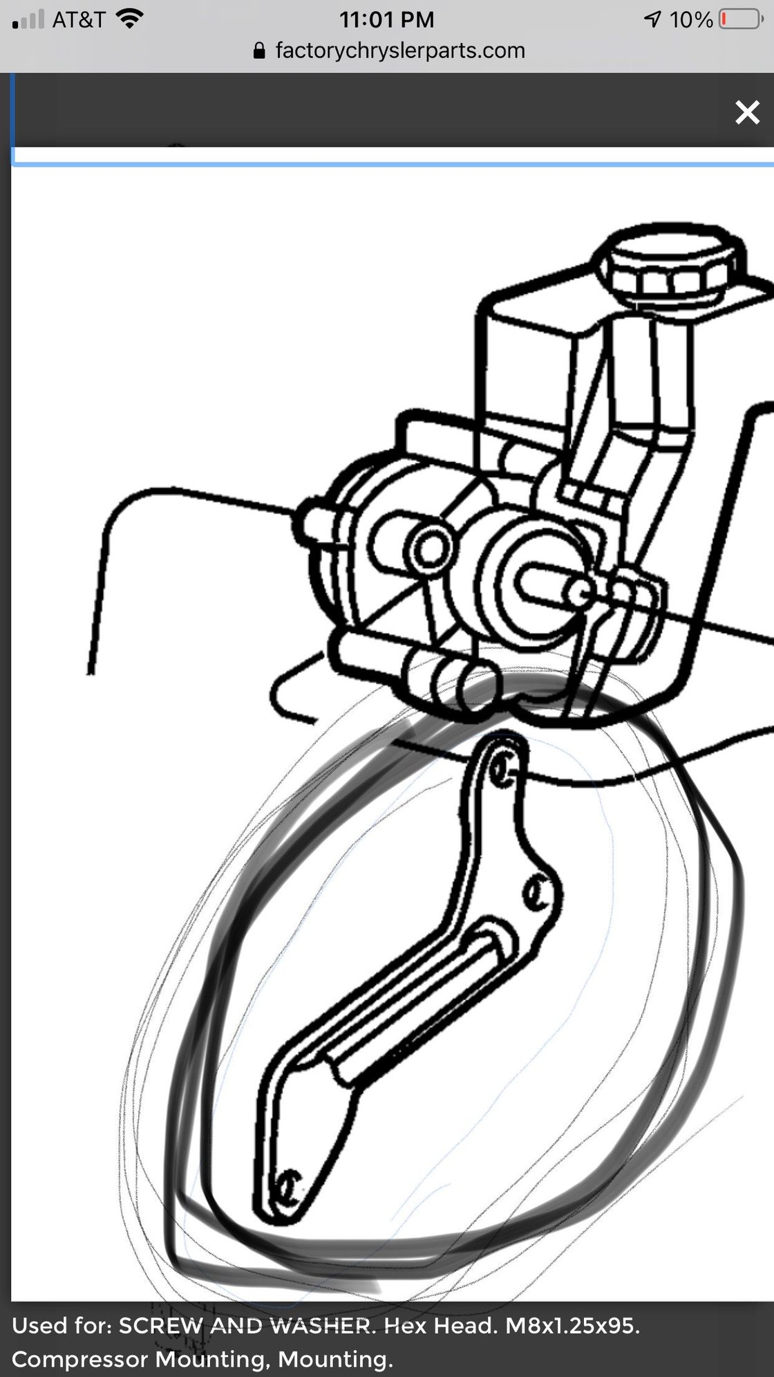

I have a 2003 dodge Dakota and I can’t remember where this bracket goes can anyone help me
Where does this bracket go on a 2003 dodge Dakota
