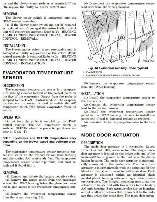

For my 2004 Dakota, does anyone know if I can access the evaporator temperature sensor without removing the entire dash? I have heard it can be accessed through a panel below the glove box, but am seeing some conflicting information. Thank you!

I found this on a Durango forum thread from years ago where it mentions an access panel, but someone later mentioned they had trouble finding an access panel there. My mechanic quoted me .5 hours of labor to replace it, which leads me to believe it wouldn't involve an entire dash removal. Would love to do it myself if I can figure out how to get to it!
