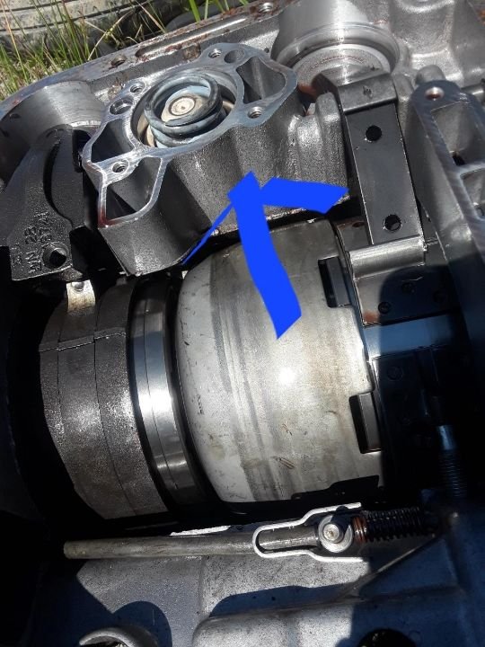

governor pressure solenoid, shift solenoid issue. Also, very possible a band strut fell down into the pan from not being adjusted, although you would have found that when you changed fluid.

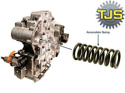

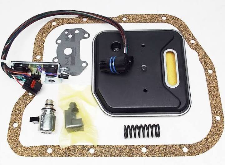

Yea, replace the solenoid..An fresh fluid/ new filter .
An look at that darn accumulator spring while your in there.. a very common problem in these trucks -accumulator springs pop or break.
Easy to look at.
Mine was in 4 pieces.
a kit is a good idea too but you may only need solonoid, filter an possibly spring [$10]
