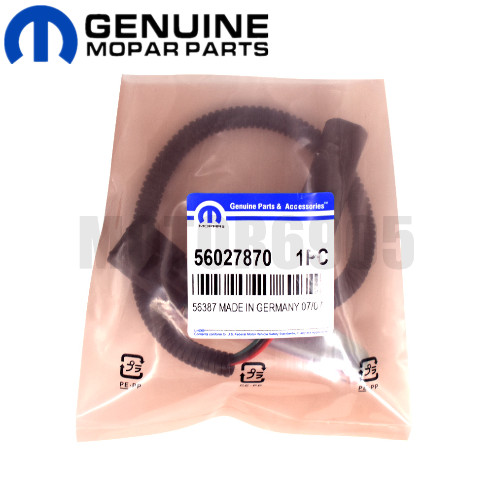

Found the CKP Sensor in the truck, although it looked new, was aftermarket. I installed the OEM Sensor (Mopar Part Number: 56027870), and went for a test drive. ECM was clear of codes (as I disconnected the battery when replacing) and it remained clear of codes after 15 mile drive. I went into O/D many times (both up and down hill). It was very smooth, not even the slightest lurch. I never knew a CKP Sensor could only partially work, but this experience has made it very clear that the aftermarket one in the truck was bad news.
I'll post again after cold start tomorrow morning.
Here's a picture of the CKP sensor I used:
