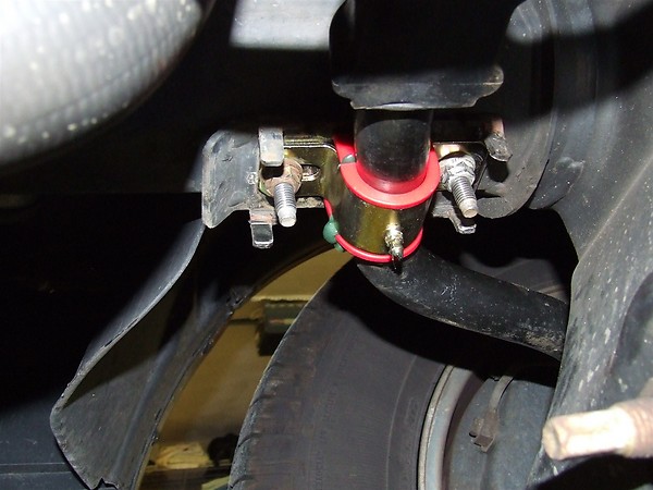

Originally Posted by MIKEon22s
You need to just bend the 4 tabs down, and hell leave them on the bar just slde them to the side. You do not need to press anything out to change the front swaybar bushings. If you look close you can see my old black one jsut slid over a little . A hack say will cut a slot in it then remove.
HI MIKEon22s
Can you tell me where you got the bushing with grease fitting and Brand
Thank you
ALCON

MIKEon22s's Avatar
MIKEon22s
Joined: Sep 2008
Posts: 680
From: RI
Default SWAYBAR bushing
Thats just a 33mm 1.25" Energy Suspension universal. It didnt hold up well as the metal eventually bent allowing the bar to pull dow., Once this happened all the good of a tight bushign was lost. Some minor modifications to the U brakcet would solve that. I did find a poly bushing with graphite impregnitated in it that was or a 2500 RAM and was a 100% match for the factory braacket. Much better. Also found some great ends bushing in poly as well. Was a night and day difference and still very tight with no squeaks a year later.
