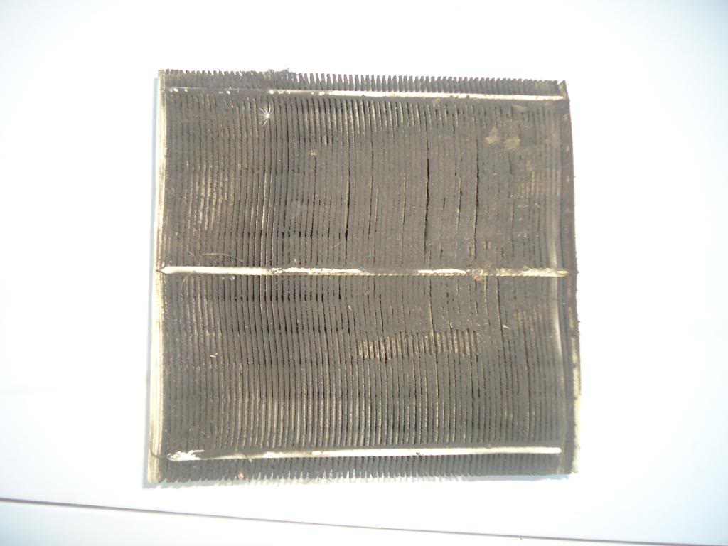

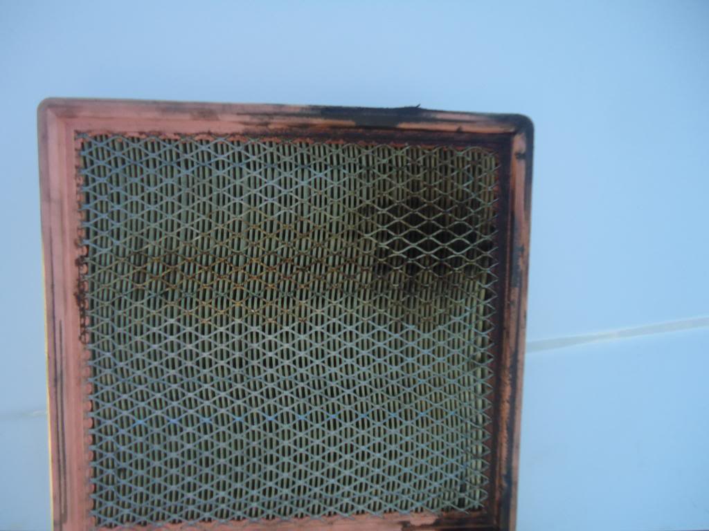

Hey everyone, I finally picked up an 04 durango for my wife, got it cheap from an auction yard..heres the specs....04, 5.7 hemi,4x4,3rd row seat,dvd,w yada yada..70k miles,magaflow exhaust.
Wont start... heres what ive checked;
Has spark(checked front plug wire,not coil wire)
Fuel pressure goes up between 55 and 60 and slowly drops
Checked fuses and relays
Found a broke ground wire and fixed
Found breather tube from oil is or was spitting oil on air filter(pics)
Got 3 codes....
b223d-air bag
b1ba6-air bag
b210d- low voltage or bad groung( battery was dead when i got it plus broken ground.)
If I turn key on,cel stays lit,then blinks,then stays lit.
Im gonna check compression tomorrow.
Dont think its security because that causes it to die after a few seconds,mine will crank but not start..seems to be turning over fairly slow but not sure..
Any other ideas? Thanks
