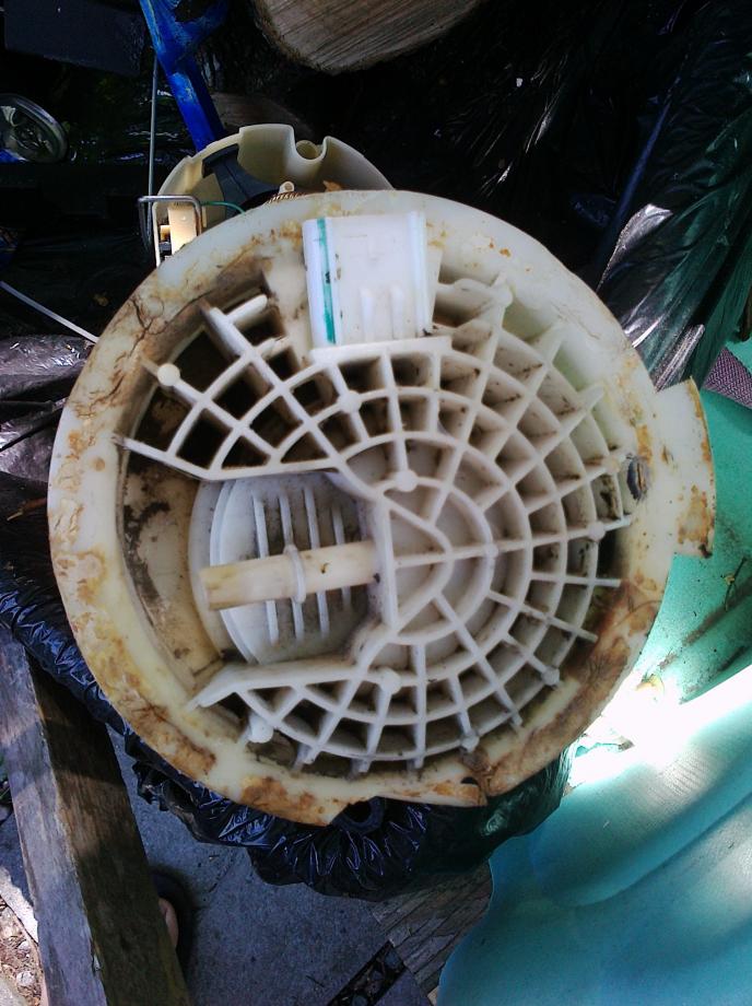

Well it's been 24 days now no CEL. The reason why I replace the Fuel Pump was because of hair line cracks on the top flange on and around where the O-ring sets and where the lock ring pushes down. The fuel burping has not happened, the last two times I filled her up. So far I'm doing well I’m almost certain that I have cured the problem. If is possible for you lower your fuel tank. Remove your fuel pump and conduct a visual inspection specially the area around the surface where the lock ring sets at. I will try to take pictures at my old FP and post for reference.

I am happy to report that the new fuel pump assembly (RL135549AC) is installed and running great! I have not driven the D more than 30 miles or so, and have my fingers crossed as the CE light remains dark!
I have pics to document what I found, and will post them when I can. Suffice it to say that there were indeed cracks around the circumference of the top of the pump housing.
These cracks appear to have been caused by Chrysler's choice to use a very cheap metal for the FP lock ring.
You would not believe how much rust was in and around that ring. I soaked the thing several times with WD40 and PB Blaster in hopes I could remove it without damaging the teeth on the companion ring moulded onto the tank.
While I was successful there, the $20 ring itself pretty much came apart requiring me to make an unexpected 120 mile round trip to Dayton, Ohio to the dealer there who had one. (52110282AA)
For a vehicle that stickered for over 40K new, Chrysler could have spent a few more pennies and saved a number of us an early multi hundred dollar repair.
I believe a few folks have said that the rust was so bad on their tank that it too was replaced. Tank, pump, and labor could easily be a $1500 repair!!!!!
There was nothing wrong with the $200 pump itself. It ran fine. The rust from the cheap ring is the culprit here.

Don,
I'm glad to hear that you got the job done on your D. So far the CE light has remained dark on mine. I do agree on the rust there. I saw pine cones and pine needles on mine so I figured that the rust was from probably squirrel urine or some other body fluids. I do agree they should either protect or plate the lock ring better and for the price tag, they should do a better job there as well.
