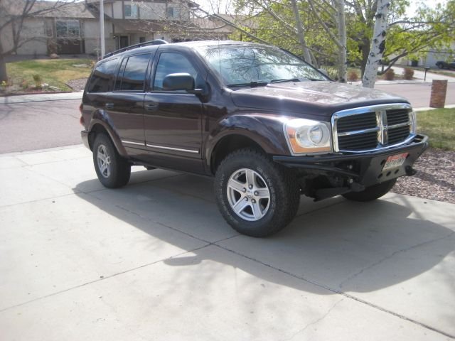

I finally have a pic.
Wow, beautiful, where did you get that front bumper?

Rango226
Nice ride! I think you have me beat on the looks. Wow!
There is a company here called Hefty Fab Works. A truck rolled backwards into my Durango and bent the stock bumper. So I had this bumper created for me. It has a skid plate that goes from the bumper to the ?crossmember? underneath so to protect the radiator with 1/4" steel.
It is not winch worthy; just something to tug on with a recovery rope or something. I didn't really want a winch and the guy who did the work said he used his winch more for pulling everyone else out than himself so I saved some $ on not having it winch worthy. Plus the octagonal frame is probably not as strong. I paid $750 for the bumper and skid.
So the question is: Do your 33" tires rub at all? You are using spacers on the back?
I have trouble with people door dinging me so I am moving the door trim up; more pics coming.
I also added a new muffler: So loud it sets off car alarms Haa haaaaaa. I love it.
Rango226
My tires don't rub at all. I cranked up the torsion bar to the max and no spacers In the back. Sometimes if I hit a bump too fast the tires will hit the fender/body, but that doesn't happen often. Some better off road shocks would probably do the trick.
