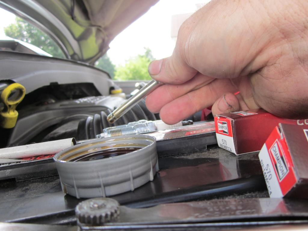

I pulled all the plugs on the drivers' side with a 1" + 3" wobble extension, and ye olde 5/8" plug socket.

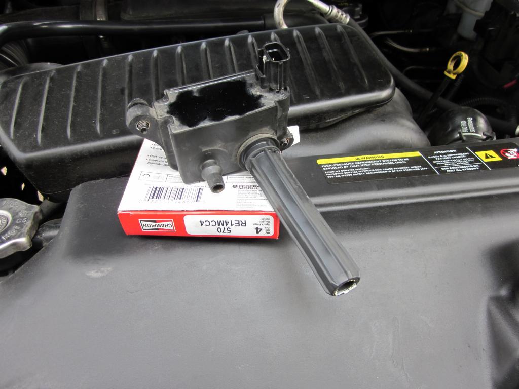

As you can see in the last pic the previous owner/mechanic decided to use lithium grease to 'lubricate' the boots, which in turn melted the boot to the plug.
Moron.
That just cost me a coil pack and a car rental. Of course it happened on #7 cylinder, next to frickin impossible. I spent an entire hour pulling the remnant of the plug boot out.
PITA, but at least now I know it's done correctly.
Dielectric grease on the boots and a dab of engine oil on the plugs.

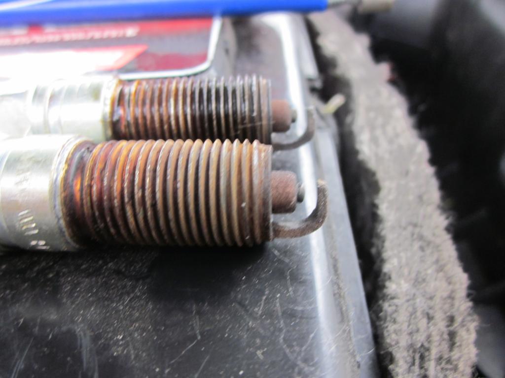

Again, all spark plugs pulled with a 3" wobble and 1" extension. Killed another boot on cylinder 2, but re-used the last good boot from #7.
It runs so smooth and silky. Well worth the effort, hopefully the fuel economy will return some of the investment costs - plugs were $36 with tax, coil pack $44.

You need compressed air for this job to blow out the spark plug holes. If one of the c.o.p. doesn't seal correctly, the resulting corrosion will head right for the combustion chamber.
