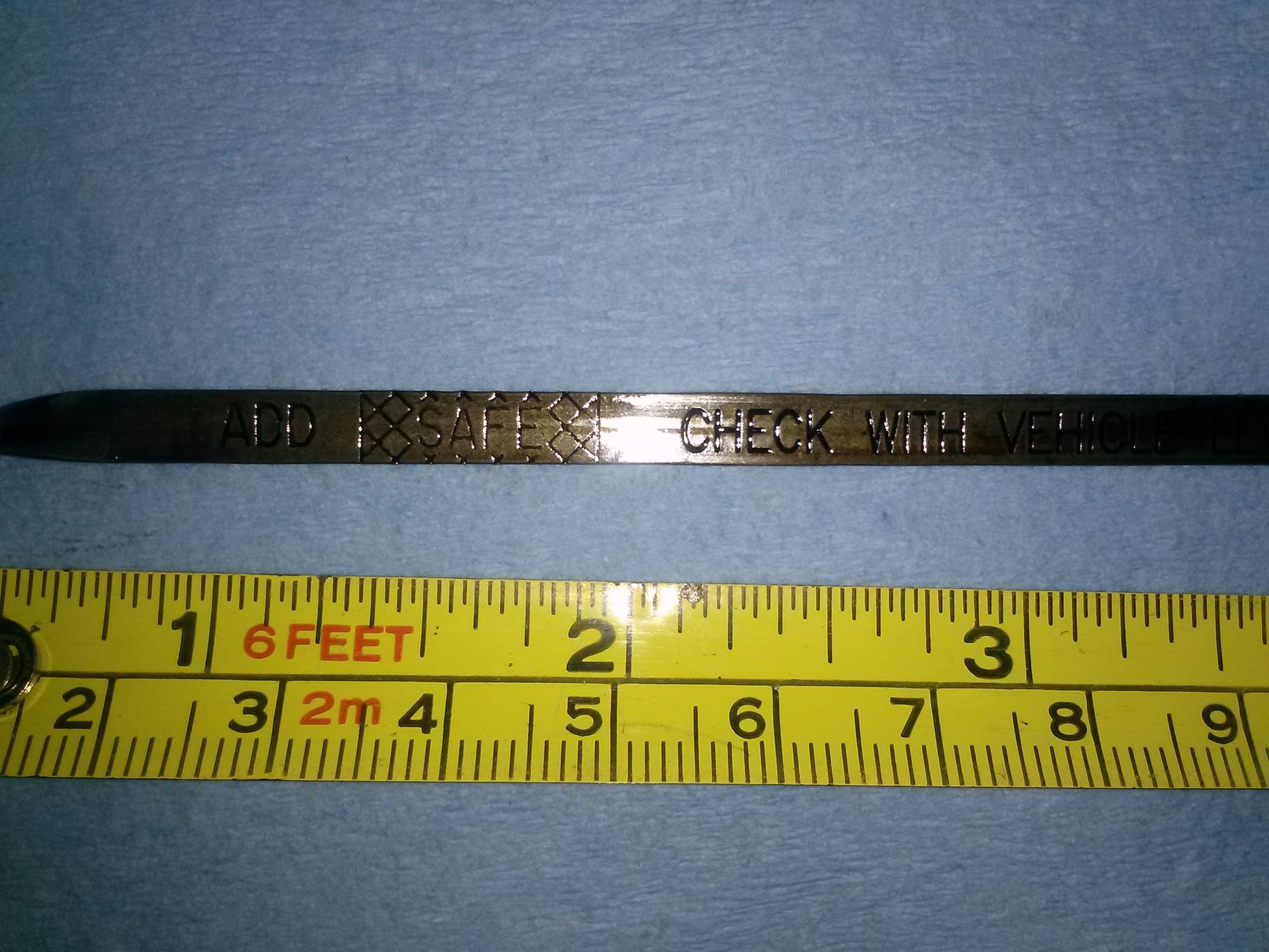

Ok so here is a little more detail. attached is a photo of the dipstick. The top safe zone is at 2 inches, the oil comes up to the 2 and half inch mark.

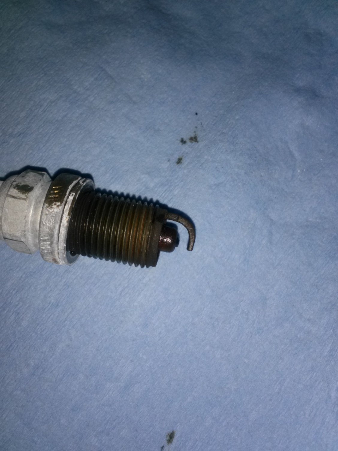

I did take out 1 spark plug, and the tip had oil on it. So, what now? *edit* that's not oil on the nut on the spark plug. Its white powdery and the powered stuff rubbed off.
I did read that if there is too much oil it can get sloshed around and air mixed with it making it a thick substance and then prevent proper circulation. Unless that happened elsewhere the oil on the stick isn't thick, so I hope that's a good sign.
