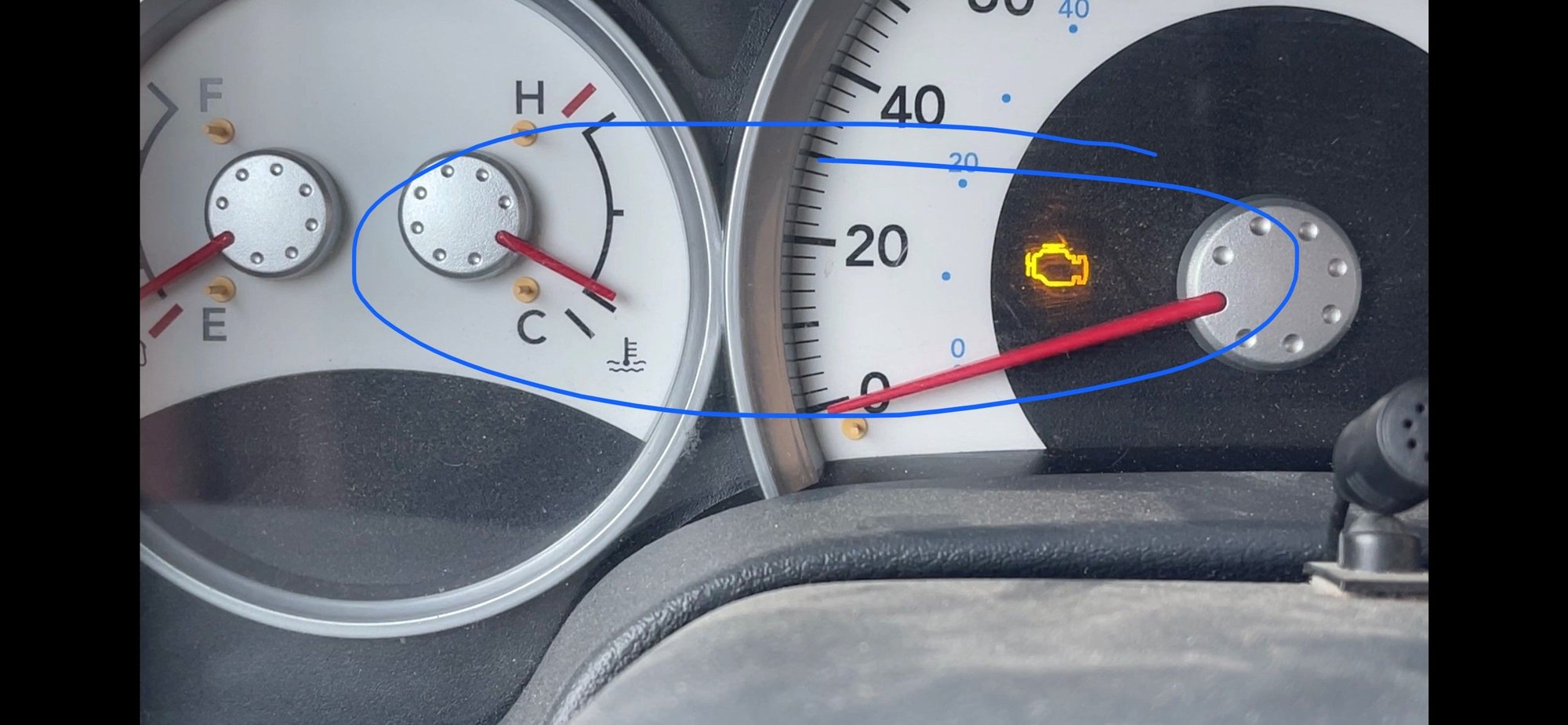

Once the Temperature goes up past the second mark on the dash (Seen in picture) the check engine light comes on, No Cruise Control, No Overdrive and P0016 code.
Stop the vehicle until the temperature cools down, truck starts and runs great until it goes past the second temp. mark, then does same thing, No Cruise, NO Overdrive and P0016 code.

After engine temperature goes over second mark. Cruise and overdrive off and CEL comes on with P0016. When cools down everything works again, until goes past second temp. mark.

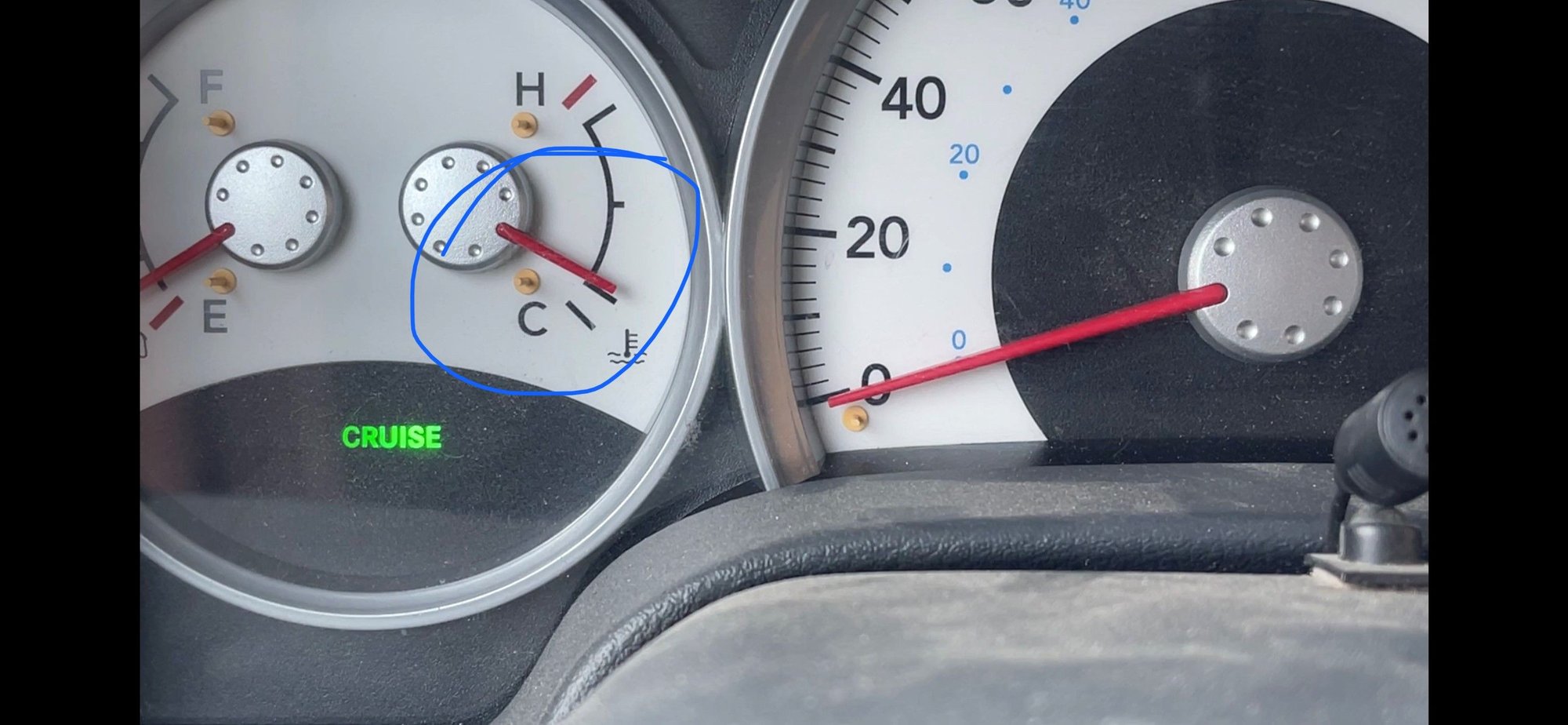

Before engine temperature goes over second mark. Cruise and overdrive still work
