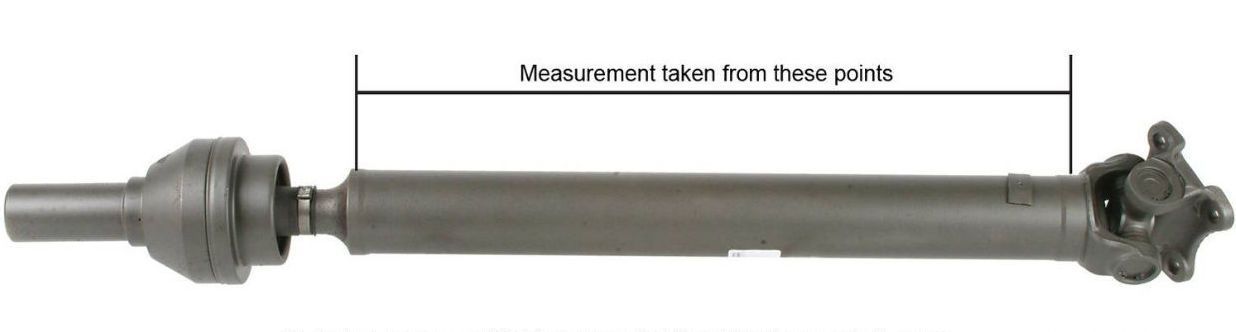

I got the job done and the front driveshaft / prop shaft replaced! I had to remove the cross member under the transmission for the transfer case shift actuator, so it was already out. I think the cross member being out would be a good idea for just the driveshaft job as well. The driver's side catalytic convertor is one piece from the exhaust manifold and is half the cross over pipe section. It had to come down for clearance to get the front driveshaft off the splines of the transfer case. Remove 2 bolts/flange to the exhaust manifold, unplug both O2 sensors (really tight to get your hands to those wire plugs) and remove the band clamp at the cross over joint directly under the transmission. My clamp was rusted and needed cut off. The clamp is no longer available from Chrysler so I ended up with a stainless 2.25" band clamp from Amazon, they were $16 for a pair.
Amazon Amazon
The big thing for the prop shaft is length and it is based on which transfer case you have. Mine was NV244 transfer case at 33.15inch measured as the picture. The NV144 transfer case uses a shorter shaft at 28.74inch and 2WD has No prop shaft.
