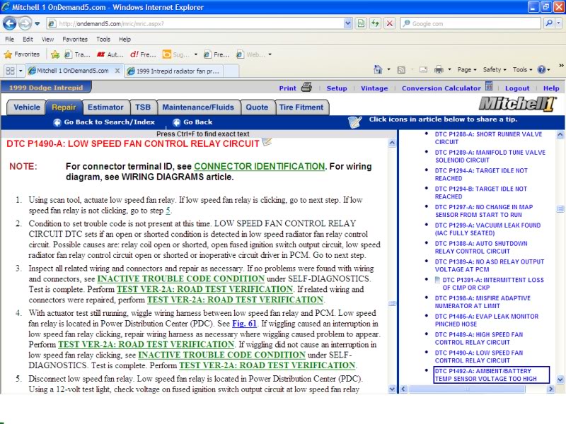

I'm dealing with the same issue as far as p1490 is concerned. Hopefully this helps a bit.
The complete step number 5 was cut off, here is the complete step.
5. Disconnect low speed fan relay. Low speed fan relay is located in Power Distribution Center. Using a 12-volt test light, check voltage on fused ignition switch output circuit at low speed fan relay connector. If test light is brightly illuminated,go to next step. If test light is not brightly illuminated,repair open fused ignition switch output circuit.
