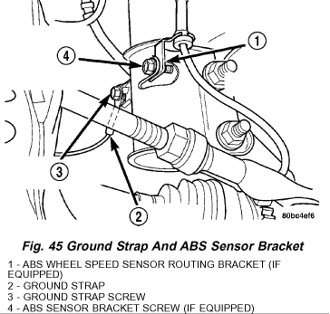

4. Remove the screw securing the ground strap to the rear of the strut.
5. If the vehicle is equipped with Antilock brakes (ABS) , remove the screw securing the ABS wheel speed sensor to the rear of the strut.
CAUTION:
The strut assembly-to-steering knuckle attaching bolts are serrated and must not be turned during removal. Hold the bolts stationary in the steering knuckle while removing the nuts, then tap the bolts out using a pin punch.
6. Remove the two bolts attaching the strut to the steering knuckle.

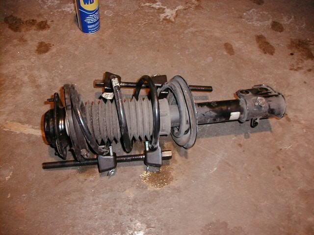

2. Position the spring compressors as shown below.
WARNING: DO NOT REMOVE THE STRUT SHAFT NUT BEFORE THE COIL SPRING IS COMPRESSED. THE COIL SPRING IS HELD UNDER PRESSURE AND MUST BE COMPRESSED, REMOVING SPRING TENSION FROM THE UPPER MOUNT AND PIVOT BEARING, BEFORE THE SHAFT NUT IS REMOVED.
3. Compress the coil spring until all coil spring tension is removed from the upper mount.

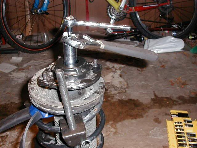

4. Once the spring is sufficiently compressed, install the custom tool shown below on the strut shaft retaining nut. Next, install a 10mm socket with extension on the hex on the end of the strut shaft. While holding the strut shaft from turning, remove the nut from the strut shaft.
(Pictures is a pair of vice-grips and a tractor spark plug socket)
(Pictured below is a 21mm 1/2" drive deepwell socket with a 10mm socket and extension)
