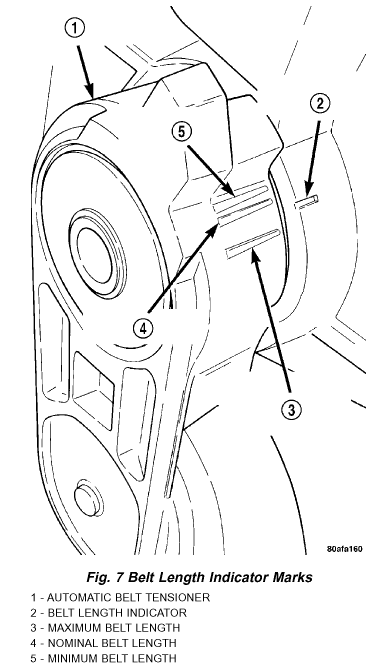

3. After belt is installed, inspect belt length indicator marks (Fig. 7). The indicator mark should be within the minimum belt length and maximum belt length marks. On a new belt, the indicator mark should align approximately with the nominal belt length mark.
