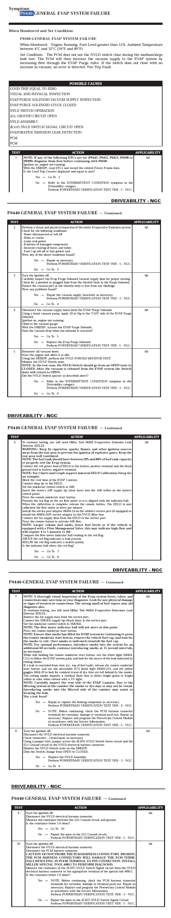

ORIGINAL: kinoman2002
If P0440 problem still exists when can I expect to come backto my dashboard.I've heard 200-300 miles but I don't have any experience with that. I've never had "check engine" on any of my previous cars.
Check out the pic i posted of the service manual... Most of it you probably won't understand because its instructions for the DRBIII tool.
Note the "When Monitored" and "Set Condition" areas at the top. In a nutshell, as long as you have more than 12% of gas in your tank it would have already checked and you would have seen the light.
remember, at least 3 clicks on the gas cap when putting back on.
