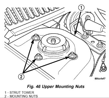

8. Remove the three nuts attaching the upper mount of the strut assembly to the vehicle's strut tower.

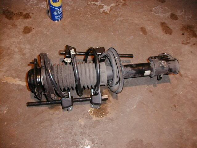

For the disassembly and assembly of the strut assembly, use strut spring compressor, or the equivalent, to compress the coil spring. Follow the manufacturer's instructions closely.
1. If both struts are being serviced at the same time, mark the coil spring and strut assembly according to which side of the vehicle the strut was removed from, and which strut the coil spring was removed from.
2. Position the spring compressors as shown below.
WARNING: DO NOT REMOVE THE STRUT SHAFT NUT BEFORE THE COIL SPRING IS COMPRESSED. THE COIL SPRING IS HELD UNDER PRESSURE AND MUST BE COMPRESSED, REMOVING SPRING TENSION FROM THE UPPER MOUNT AND PIVOT BEARING, BEFORE THE SHAFT NUT IS REMOVED.
3. Compress the coil spring until all coil spring tension is removed from the upper mount.

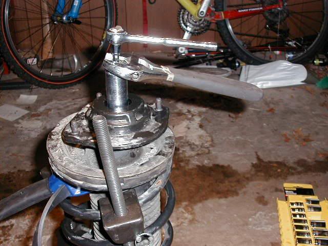

4. Once the spring is sufficiently compressed, install the custom tool shown below on the strut shaft retaining nut. Next, install a 10mm socket with extension on the hex on the end of the strut shaft. While holding the strut shaft from turning, remove the nut from the strut shaft.
(Pictures is a pair of vice-grips and a tractor spark plug socket)
(Pictured below is a 21mm 1/2" drive deepwell socket with a 10mm socket and extension)
