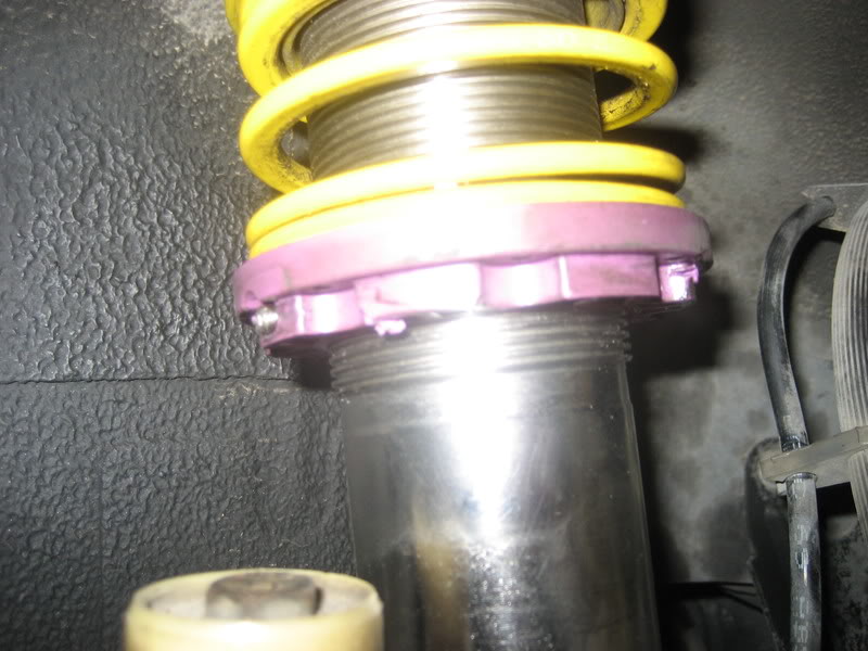

Well I have tried the PB cleaner and it didn't help with the movement. It did help with getting the bolts loose on the rear suspension when I removed the coilover....
I have came in contact with KW and need to call them again today to resolve this problem.
Here is the "seat" that the spring adjusts on.
Its made of Nylon, so the spanner wrenches are locking in correctly

does it look cross threded???? or is it just the pic???
good luck and let us know what u find out

Well the Seat wasn't x-treaded... I took to my buddies shop and we broke the coilover down and put it though a parts cleaner... It did the magic. THere was a bunch of crap in the threads, we lubed it up with silcone spray and its free moving now, I'm going to intall this weekend and I hope that there is enough clearance to take it to a shop to get the fenders rolled. we'll see.......
