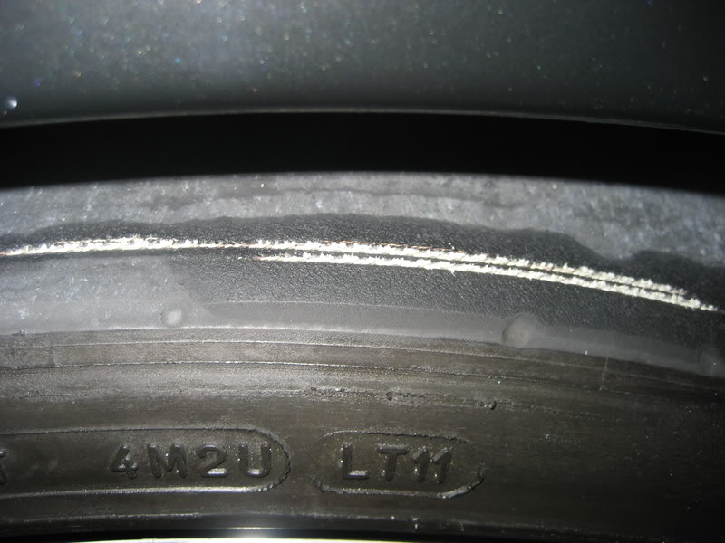

Well I decided to clean the car today after work, degrease the engine and wash the exterior for the E.D.G.E show on Saturday. While I was working on the passenger side I noticed this....

My fear is that it is not safe to drive it until I can get a new tire....
I currently have BF Goodwrich 225/35 ZR19's I'm pretty sure it will be hard to find one before the show, and will not cost me an arm and a leg..
So I will be looking around the area to see if something is possible for tomorrow.
If anyone knows a place that I can get a decient deal Let me know.

^^ why dont u find me a turbo timer for free.... u greedy bastard!!! lol, jk.... that sucks about the tire, is ur alingnment off or something nate? did just that side ware like that? i deff would not drive it like that if i were u...
but in all honestly i really glad it was just the tire.... if u know what i mean....

yeah i know... it wasn't planning on getting a new tire since its been only driven for maybe 3- 4 months one or two days a week...

Man I was worried this was a story about a accident. Man Im glad to see its just about a worn tire. Thats to bad about your tire seeing as you dont drive much. How is your alignment?

yeah.. I fixed the issue. there was a rough edge where the autobody cut my fenders and didn't roll it back. Needless to say it will be too much of a headache to get them to buy me a new tire, so I used a large hammer and beat it until it rolled up and out of the way. I moved the worn tire to the rear for now, so it can be driven and will be getting it alligned in the morning. I have come to the conclusion that if my car ever does get totaled... I'm getting a challenger or a GTO...
