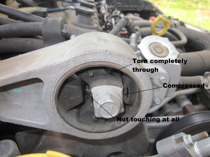

On to the next issue to fix...looks like both the top and bottom motor mounts are shot...here's a pic of the top one...bottom one looks about the same...

The motor mount: Mine looks worse, but I don't notice any issues as far as the engine torquing. The rubber on mine is torn all to hell.
