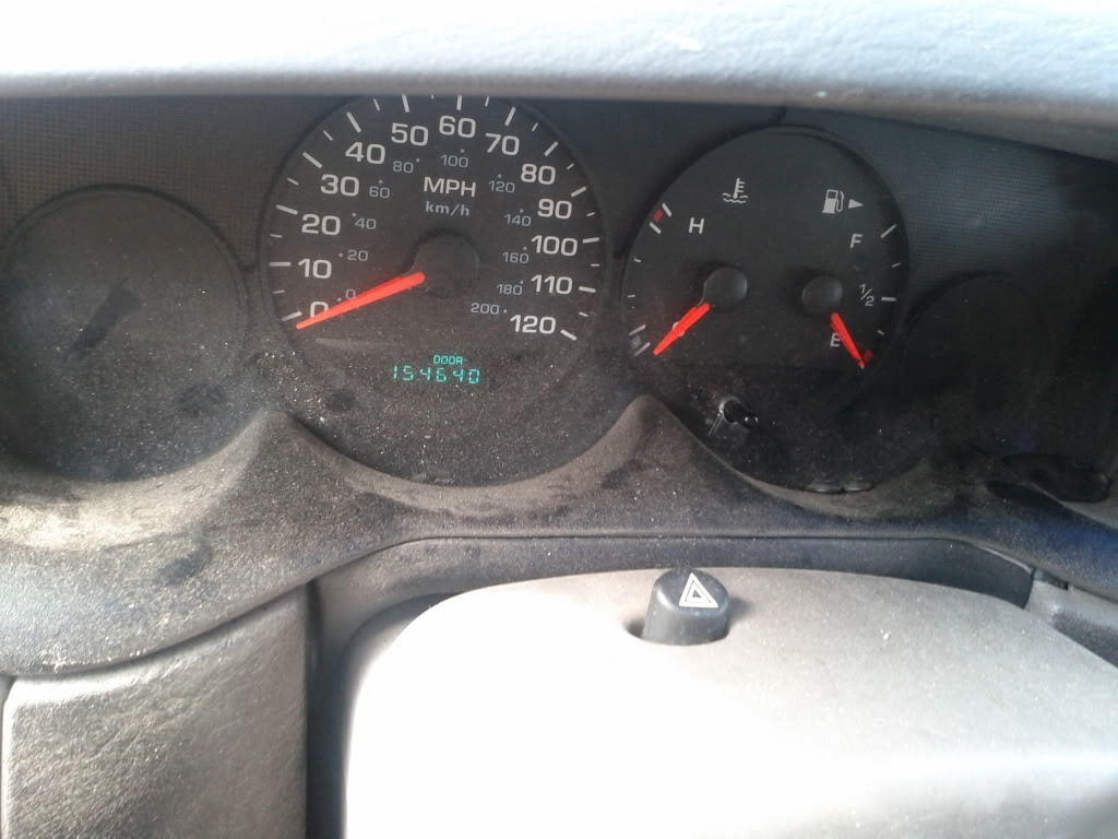

Nope. I have a 2000 with an auto and put in a cluster from a 2003 SXT with a manual because of the tach.
Before:
After:
