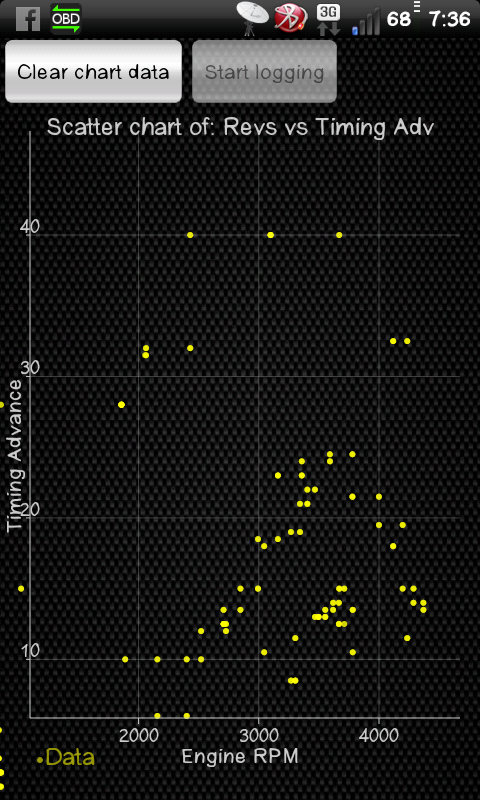

This is what I got with the engine at normal operational temp and WOT

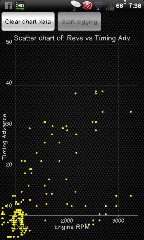

This is with the engine cold at WOT
Old Aug 12, 2012 | 08:29 PM
Mike Hillman's Avatar
Mike Hillman
Joined: Aug 2012
Posts: 13
short term is around -2 long term around -10 .. not sure if that is a good figure but before i changed the o2 sensor they were both at +24.2 ..
If the belt was a little stretched or a failing tensoner would it slack off the belt say half a tooth and cause the low power, poor acceleration and the poor fuel mileage..
did a compression test today had 205, 210, 215, 205 so i am pretty sure the engine is healthy..
would advanced or retarded timing cause it to run rich and burnout the o2?
perhaps a fuel injector is going bad and either delivering too much fuel or not enough and the computer senses a lean condition and fattens the mixture up even more?
Old Aug 12, 2012 | 08:32 PM
Mike Hillman
Joined: Aug 2012
Posts: 13
Looks pretty close to mine...
Think i might hit the local upull tommorow and pull a set of injectors and try some different ones out and see what happens..
